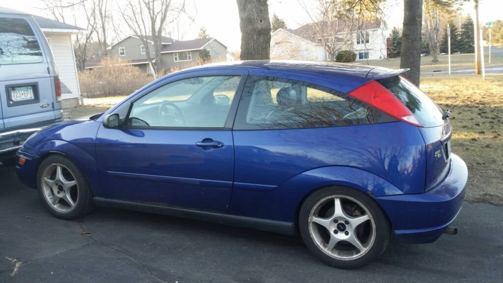

Lucy is Home! Time to fix some Valves!
We played the largest tug-of-war I've seen, A Focus between 2 Vans, to get it off of the trailer. Damn those U-Haul tow dollies and their deep wheel pockets!
Hopefully, she'll be done by FocusFest!
