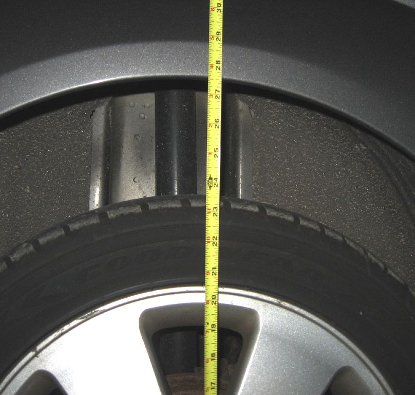

I found a stickied thread that specifies the ZX3 height as 56.3 inches. Mine measures 58" at the highest point of the roof (~rear seats), and the lip of my rear wheel well is 27.5 inches:
(front = 26")
Can someone with an older stock ZX3 do some quick measurements on your own car?
I've been trying to diagnose a touchy/rough ride, and when I parked beside another older stock ZX3 this past week, it seemed like my rear wheel wells were a few inches higher than his.
My suspension = stock (Monroe); springs & dampeners on front & rear about a year old. (No junk in my trunk, except factory spare tire & jack; photo taken with ~1/4 tank of gas.)

Yikes. I'm 5.5" lower than you, lol.
I wouldn't worry so much about height as I would about worn bushings and alignment (though judging by the dust line on the tire alignment looks good).

measured @ top of wheel well lip: rear = 27.5 inches, front = 26 inches (see post #1 on this thread)
