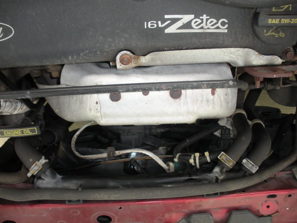

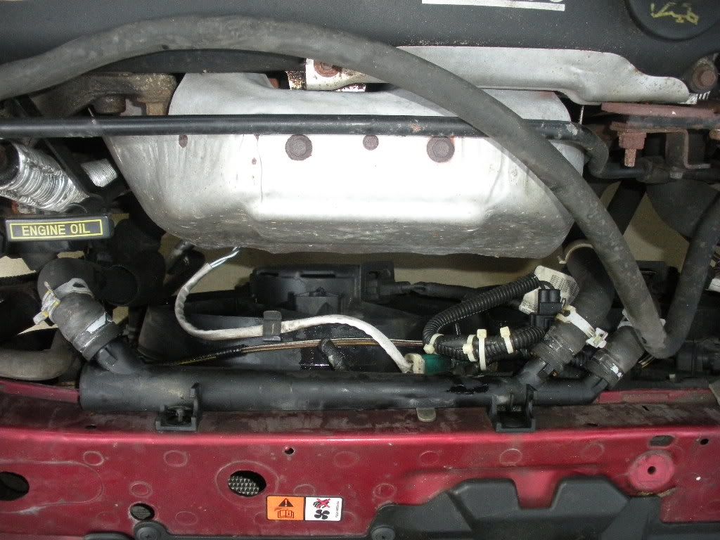

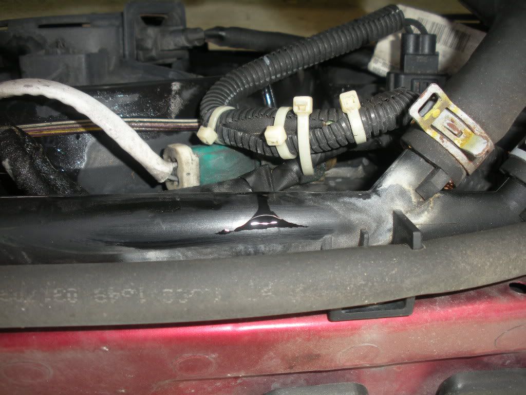

I have noticed two small lightly discolored spots on the ground under the car. When under the car, I see a drop of a clear oily substance getting ready to drip from the bottom center of the fan shroud and then again about 8 inches to the right of the shroud. The antifreeze is green, the power steering uses ATF, I have had to add freon last summer that had a sealer and is green. I can't figure out what and where this is coming from. It drips a drop or two every day. Whatever this stuff is, it is colorless. Any ideas where this is coming from??

Radiator pipe - at least you didn't blow the cap out the end with sudden disastrous results (complete loss of coolant) like some who've posted here...
Ford part, not expensive I understand, just a PITA to have to do it....

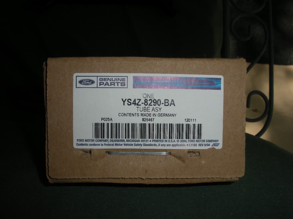

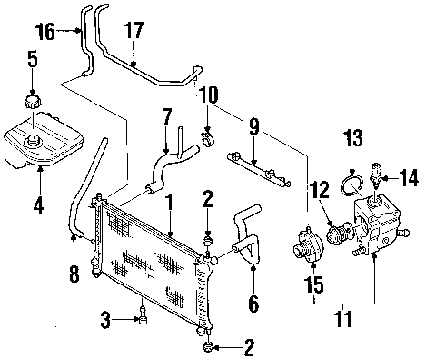

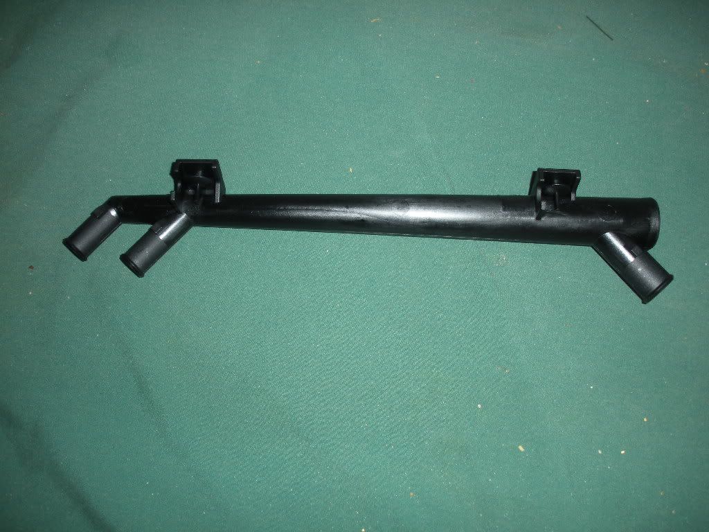

Got the Ford part this morning and was an easy install. Part that leaked is Item #9 in parts breakout. Ford P/N YS4Z-8290-BA. It is a good sign that this replacement is made in Germany and not you-know-where. Part cost $23.
Attached are photos:
http://i245.photobucket.com/albums/gg52/jay1047/fordpartnumber.jpg
http://i245.photobucket.com/albums/gg52/jay1047/newone.jpg
http://i245.photobucket.com/albums/gg52/jay1047/incar.jpg
http://i245.photobucket.com/albums/gg52/jay1047/focuscooling.gif
Thanks for everyone's help in identifying this strange part.
