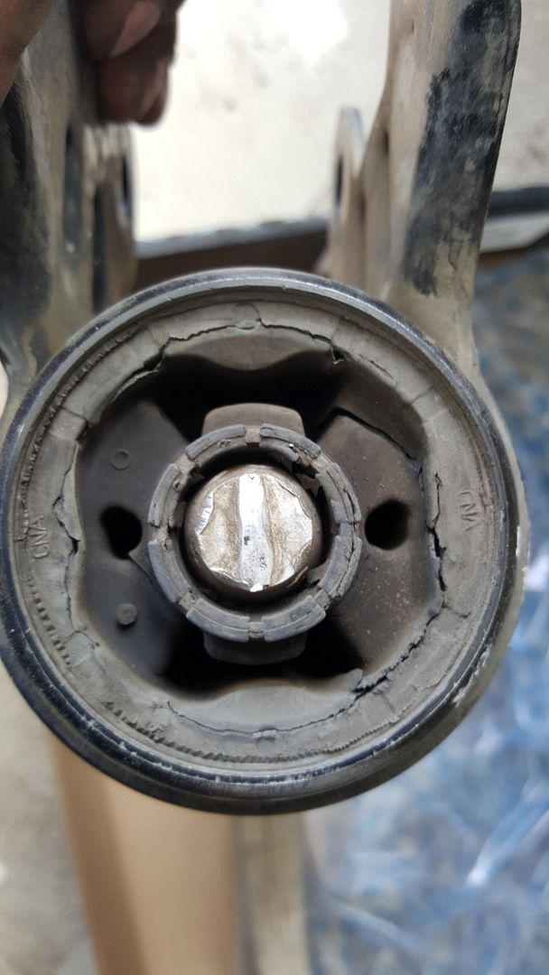

I've mentioned a few months ago that my Focus SE '12 started to "clak" when going over bumps and that after a little check underneath, I've discovered that the lower control arm bushings were almost done.
Now though, many of you might noticed that this specific part cannot be changed so the whole control arm + ball joint has to be purchased. I've changed mines and here is the DIY:

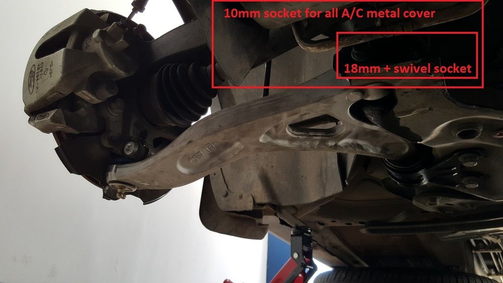

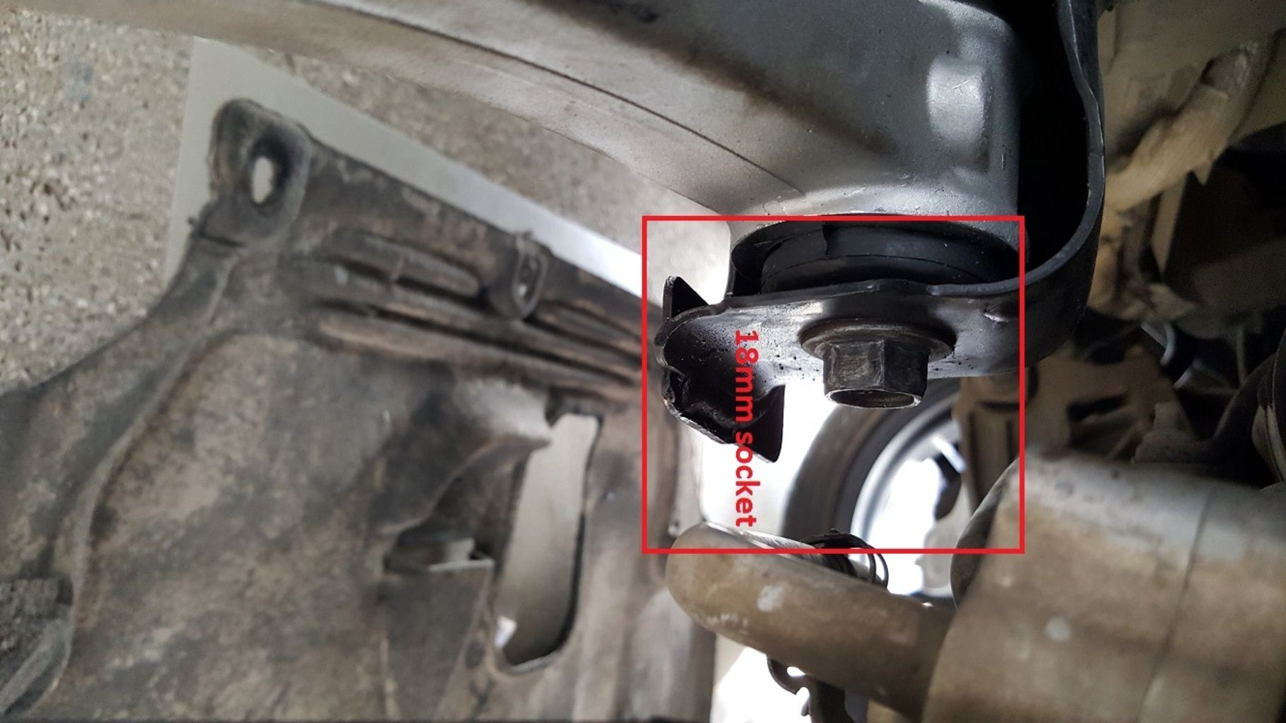

2-Loose the suspension lower control front arm bushing bolt using the 18mm socket (passenger side requires to remove the lower metal cover for the A/C compresor *all bolts use a 10mm socket * so you can use the swivel socket + 18mm socket to take this bolt entirely).

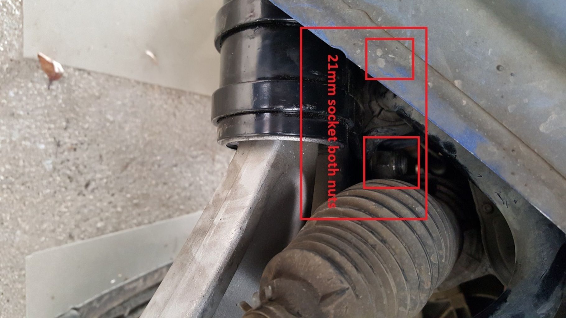

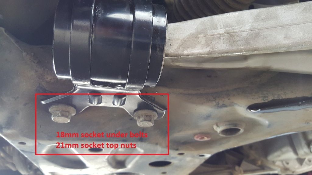

3-Loose the suspension lower control rear arm bushing under bolts using the 18mm socket and the 21mm socket for the upper nuts.

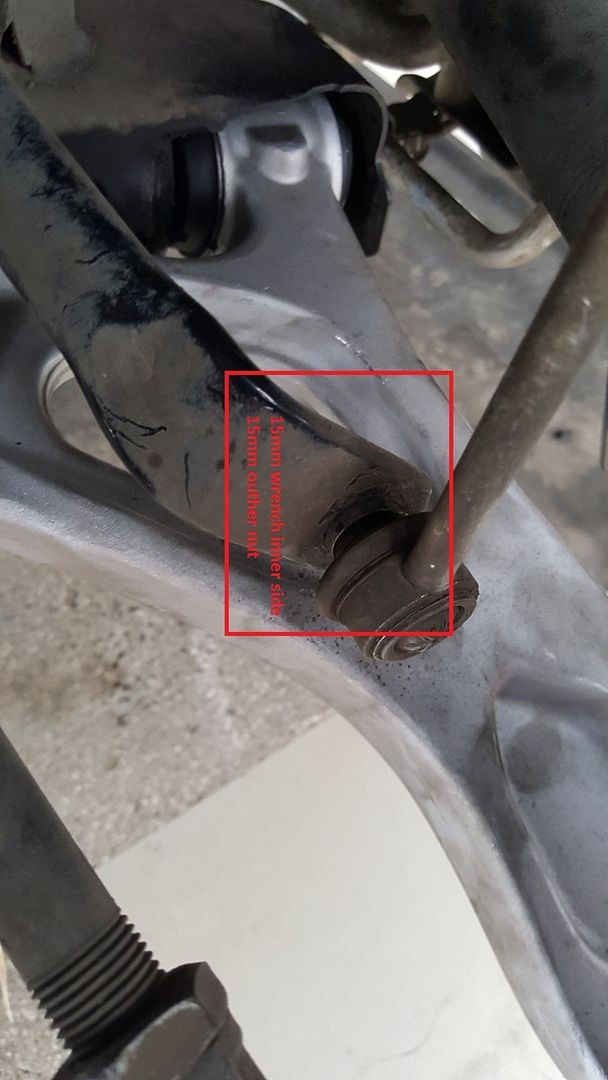

4-Remove the lower bolt on the sway bar links using a 15mm wrench and 15mm socket for the nut in it.

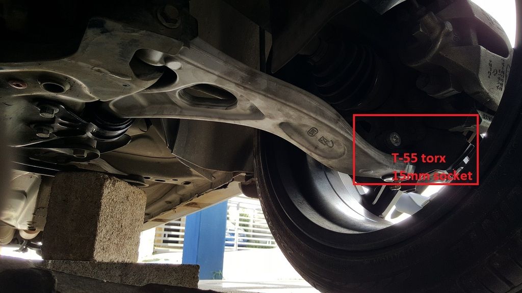

5-Remove the ball joint bolt and nut using the torx T-55 + 15mm socket.

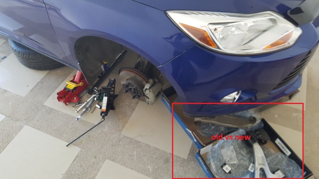

7-Remove the whole control arm from both sides.
Installation procedure is exactly the same going backwards.

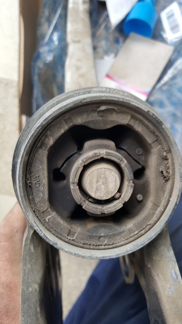

With just raising the car and doing a visual inspection you will see the status of them.. any rip's withing the rubber will mean that the bushing is up to be changed.
When you take the control arms apart from the car, you will notice the huge difference in movement on the bushing while on the new ones it's almost impossible to move with your bare hands.
