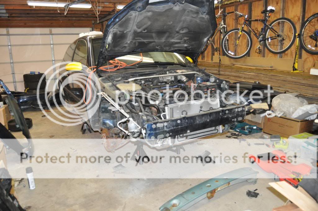

Update from the weekend:
-Removed front lower subframe
-Removed radiator
-cut out front bumper
I think I will be able to mount the euro front bumper onto the stock plates but room will be tight
I also noticed the two plates are not mounted symetrical to each other (notice the angle on this one where the other is flush)
I also found some extra wiring work as the previous owner thought is was a good idea to wire strobes and other electronics into the ignition and oil pump harness.[?|]
Next:
-pulling engine and everything else from engine bay
-finish removing heat shields
