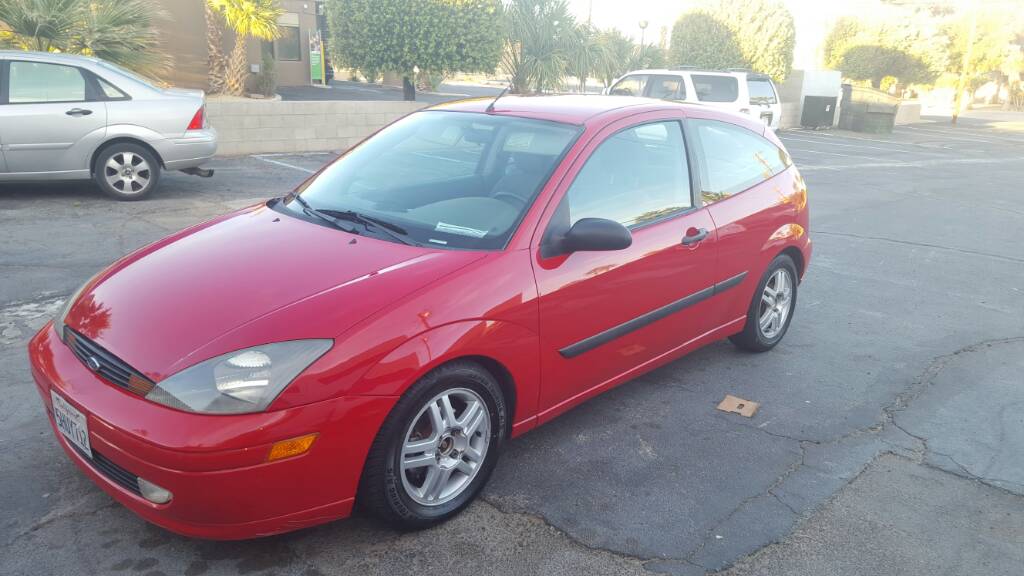

Hello all. I've been driving this race red 2004 Focus ZX3 PZEV 5speed for about 4 years, love the handling ect ect, put some orange Konis and Eibach springs on its all stock apart from that. 103,689 miles.
I'm looking st getting a low mielage d25 from a Fusion at my local junkyard, pull it apart, new gaskets and rings, run with it the d23 head, polished and fresh valve job and maybe cams, maybe. K&N typhoon and a full exhaust system. That's it, I'll keep the mostly stock appearance for now visually.
I'm a food delivery driver for a high end restaurant, I pound out 100-250 miles a day, 6 days a week like clockwork in mixed city/highway. Driving habits depends on my mood and price of gas, my car is meticulously maintained by myself and runs like new. I've been known to let loose on other 4 banger ricers and stupid ass stacked diesels and I win a decent majority of them time lol. Need more power! And I can't do a turbo, SMOG bullshit.
Can a 2.5 swap do it??
