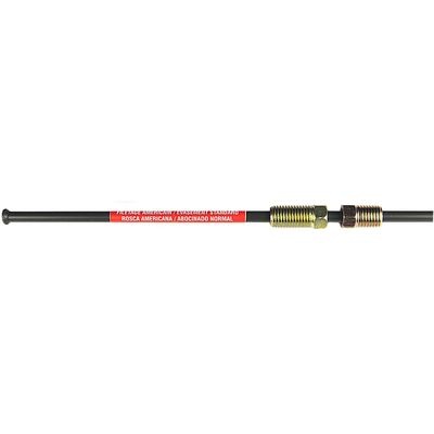

I looked back over what I found online, I'm pretty sure this is the same as I got. It's a little hard to see, it says 4.77mm X 30.5. Am I correct in thinking it's the wrong thread? Close, but not quite right?

It clearly says metric thread. The 4.77mm is 3/16", the 30.5 CENTIMETER is the length, one inch = 2.54 centimeters, work the equation out and it should hit the 12 inch length there.
The end of the two fittings that backs up the flare looks incorrect there and why it leaked? The inner end of the fitting should have the same 45 degree angle the wheel cylinder does but the female to the male of it. Flare fitting ends generally do not have that step sticking out past the threads there. I'd be looking close at that. I could be full of it of course, I could tell if I had it in hand instantly but the web, you know.

Those look right. Is the fitting too short?
The Focus wheel cylinders should be M10x1.0 ISO Bubble Flare, which is what those are. The Ford flare nuts are usually on the long side, but they usually don't thread in all the way and I've used short flare nuts on my Mustang lines; as long as the end bottoms out before the threads do, it should work.
One thing it could be is if 12" is just so much too short that the line is pulling tight and making it feel like the fitting is tight, when it isn't. How much muscle did you put into tightening the flare nut?
EDIT: Assuming that you did actually get the line you show in the picture. Double check that the ends are actually bubble flare and not a double-flare type. I usually think of Metric as being simpler (once you know the ins and outs) but brake lines/pipe and tubing in the Euro and Japanese forms of Metric are one huge exception.

Ok, it is the right line, the problem was I'd bent a little too close to the end, it wasn't seating right. The original line, after I cut it off measured a hair over 13 1/2". The replacement is only 12". I finally got it bent so it works and doesn't leak, but I can't get the clip on that holds the connection between the metal line and the rubber one. It's just too short. I'll have to put something in there to keep the line from rubbing on the hard metal edge. Piece of plastic tubing or some such. Come to think of it, I have just the thing.
