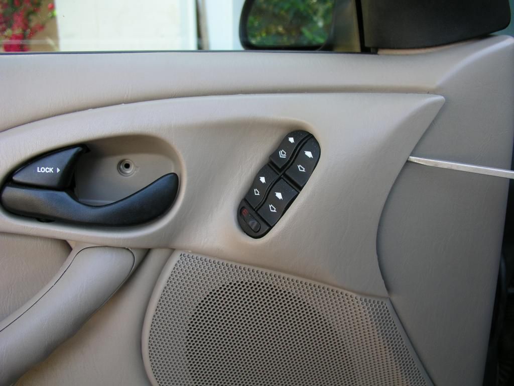

Removed one torx screw and pried the bezel away starting at where you see screwdriver (below).

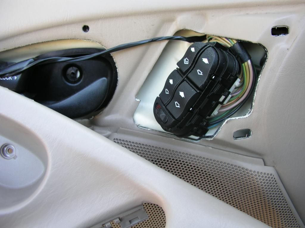

Using only your hand, reach behind the bezel and unsnap the switch from the plastic clips. Then open the door handle to get the bezel fully removed.
