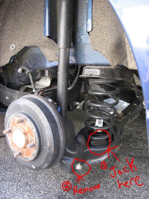

So, I'm following this guide to replace my springs to SVT springs and this stupid bolt won't come off...It actually stated to strip. I had a coil compressor, but it didn't work, too big...(see below). Anyone suggestions or anyone want to buy some 20k SVT springs lol????

Stripping it? Are you sure you are using the correct size socket? If shouldn't strip at all. That bolt is a high grade of strength steel and if anything it should be ruining your sockets if anything. Um. Be sure to get the right socket on there and then get yourself a nice 2 foot piece of piping or something to use as a breaker bar.
I am assuming though that picture is not of your ST as it has drums. Is there a lot of rust on the bolt? It could just be fused in there and no amount of torque will turn it. Basically have to cut it out at that point.
#8 ·
I'm using a 15 mm and yes, that is not my car. The rust is minimal. Should I use a different bolt size, anyone know? I have a breaker bar.

That bolt goes through a metal sleeve which is probably where it's stuck.
Go to a hardware store and buy a cheap socket-you're gonna be smacking the crap out of it. Hose it down with WD40 or similar stuff. And I mean hose it down-all possible angles and directions. Jack up the control arm under the spring, but only enough to release any tension on the joint, so you are only going to raise it ab. 1/8". Put the socket on the bolt head and with a hammer smack it a few times. You may want to hold the socket with a pair of vise grips as it will go flying. You want to send shock waves through the bolt to break it free.

Thanks guys! Rep added. ^What happend to your control arm??? lol it looks like it's missing! lol BTW which one is the camber bolt...kind of new at this.
#20 ·
The camber bolt is an aftermarket replacement. Go to the first photo you posted. See that bolt right behind and at the top of the brake drum and in front of the shock. That's the bolt a camber bolt would replace. It holds the upper control arm to the rear hub assembly. A camber bolt would give you some rear camber adjustment where none currently exists.

its a 15mm... and that bolt has been alittle stubborn sometimes for me... but i put a floor jack under it to transfer the load of the spring back onto the suspension pieces and not so much on the bolt, like when the arm is suspended
