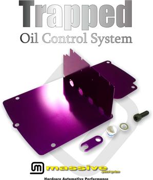

I've seen also oil pan baffles... they require a lot of testing at different force (lateral, acceleration,braking) most are custom designed... never saw a duratec kit yet!
#29 ·
http://d5otzd52uv6zz.cloudfront.net/70192ab2-01d1-4121-a19c-3c1c0ceceea8-350.jpg
This one from Massive is a basic type for an earlier duratec. They sell it along with the balance shaft delete kit now.
Same delete kit fits the current ST's, they don't list a baffle for MkIII's yet.
Fancier baffles cast into the pan would be nice, none for our cars that I've seen. English aftermarket had short pans & dry sump for earlier engines, the current TiVCT isn't supported that way AFAIK. (Silly high cost for some of the earlier duratec performance pieces)
