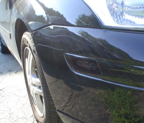

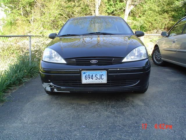

It is very good to make sure that all the lenses are perfectly clean and free of contamination. You do not need to sand the surface to make it stick. When I did my corners and grille lights, I wetsanded with 2000 grit after each coat of niteshade and clear. When you wetsand, whether is be paint, niteshade or clear, it will become hazzy/foggy. That's the "side-effect" of wetsand. To remove the hazyness, use a compound that is designed to take out the grit of sandpaper that is used. The compound I use is, Presta Ultra-Cutting Creme Light. It's designed to remove 2000grit scratches, but it's a very versitile product that can remove deeper. To get the best possible finish, I recommend to wetsand after each coat of niteshade and clear. The end product will be alot better. Depending on how it's applied, 5 coats could be alittle too dark. I understand you want it to be dark, but it may be too dark too be legal. Like I said before, I did 2 coats on mine, and it's dark, but the lights still look bright when lit. I have pictures, but better can be taken tomorrow. A bodyshop can lay down some clearcoat for you, but you can save some money by doing it yourself. If you can spray niteshade, you can spray clear. My recommendation for the brand of clear are, U-Pol or DuPont. Anything else, feel free to ask [thumb]
---Randy
edit: I apologize, but new pictures will have to wait.. My brother went to PA for some kind of reunion and took the digi. I enclosed a few pictures that I had from before...
Grille, Lights off
Grille, Lights on
