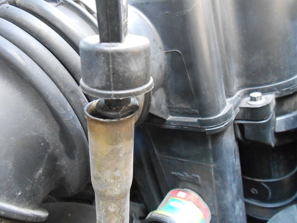

Abe, do you know if your car is a PZEV or not?
As mentioned earlier, please post a pic of your engine.
Tempted to guess, but no need to. Here are a few pics of what might be inside the OP car.
Pic below shows the gauge Sailor mentioned earlier (inside red box).

To Sailor and others: Your pictures hep me to identify engine as exactly Duratec (same plumbing) there is no match to pictures shown of other types. There is no gauge on side as mentioned. It appears to be "sealed" type . ?what next? regards, Abe G
