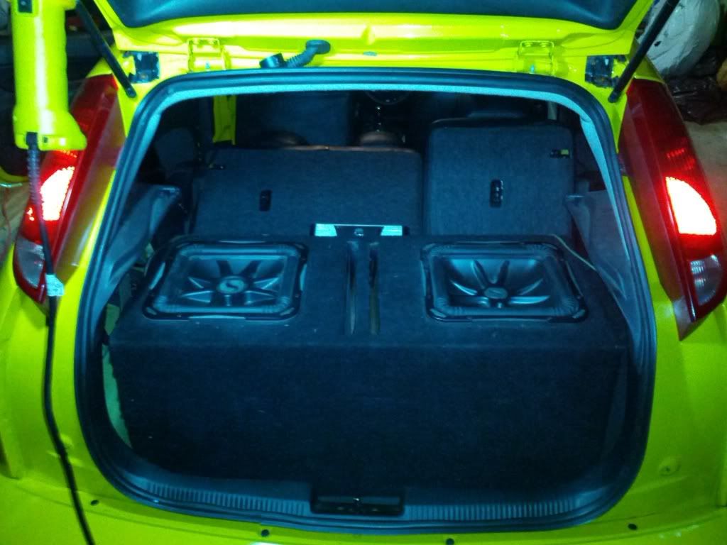

Why in gods name would you want that giant ass box back there...if you are going to go the speaker route at least get something that fits. That box is huge.
Sent from my SCH-I605 using Tapatalk 2
#20 ·
Sent from my SCH-I605 using FF Mobile
lol it serves a purpose, and that reason is the stereo comp a FF this year [grinking]
#21 ·
Good lord...you better go with a bigger turbo if you are going to be hauling that around in the back! lol

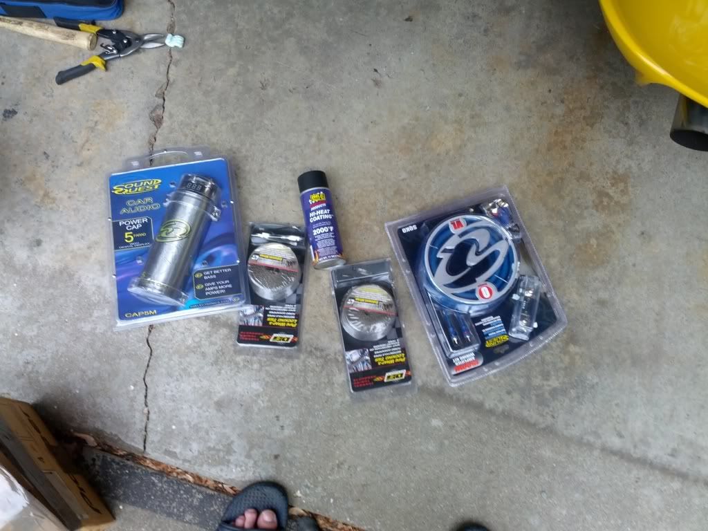

time for a new update
today I went and ordered some more parts from summit
so I'll have some more DEI wrap to finish up the header and DP
along with some new copper plugs and a new valve cover gasket
I also went a dropped of my DP at a welding shop due to there being a hair line crack in it
so as of right now all I need to do is order a new Tstat housing then my tune and the turbo build will commence so hopefully I'll have everything needed by the end of the week
