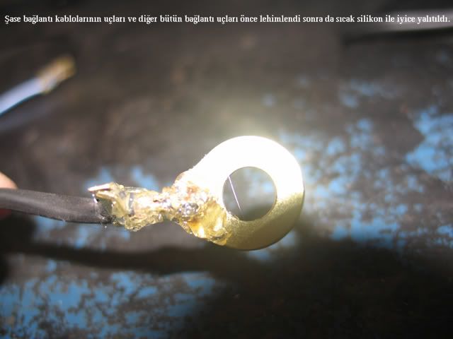

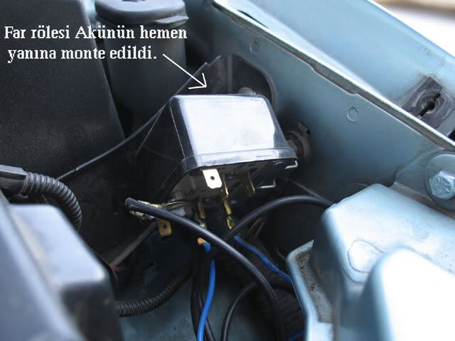

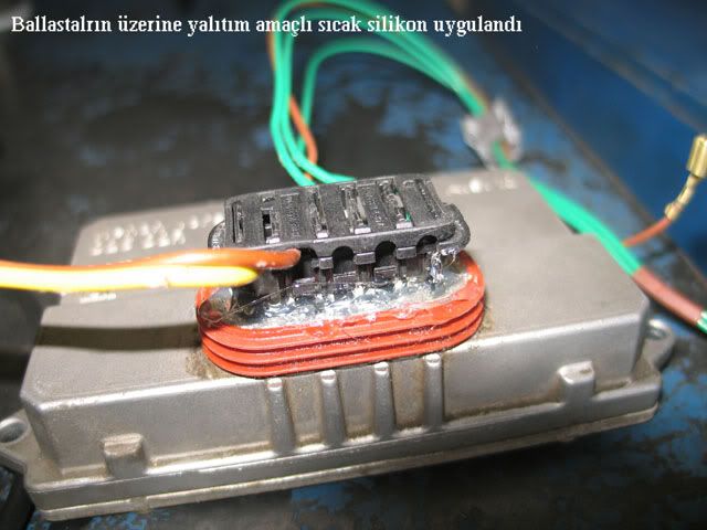

These are the photos....
MADE BY SERHAT ÞENYURT at TURKEY
Junyan headlights with angel eyes,( 400 YTL- 295 USD)
Hella ballasts and Philips 4300 K Xenon Ampoule( From Mercedes E series)(350 YTL-255 USD)
Valeo projektors ( From MEGANE II)(60 YTL - 45 USD )
Strong LEDS(for angel eyes),resistance;cable ( 10 YTL - 8 USD )
WORKER'S PAY : made by Serhat Þenyurt ( 0 YTL - 0 USD ) [thumb]
