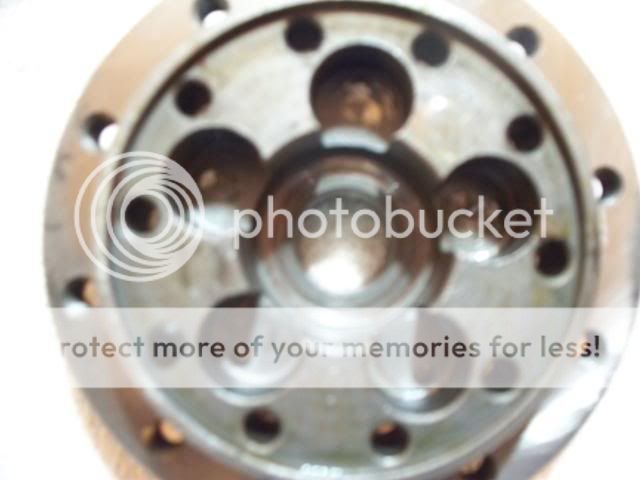

shows back of sun gear were machining is required for the axle clip to be compressed sot he axle can be pulled out

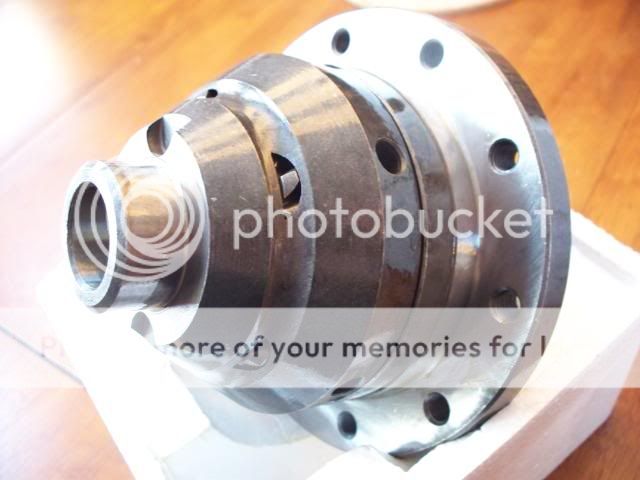

the right and wrong ways the diff can come assembled. this is what causes the belleville spring damage.
