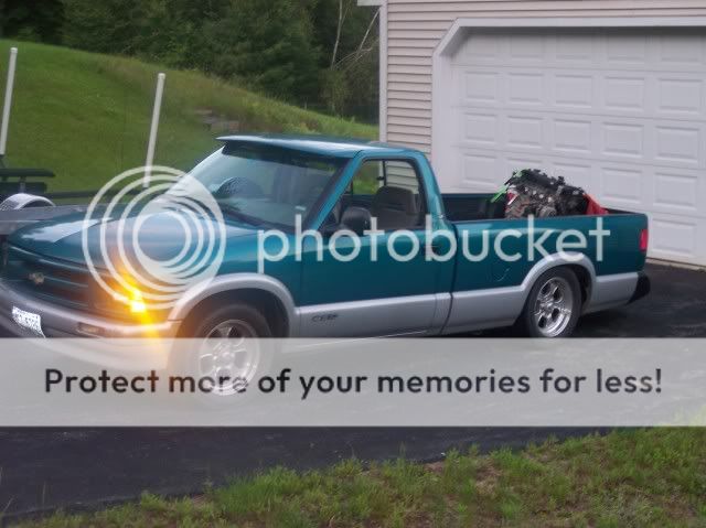

HTP got another Ford Racing head shipped in for me.
They are currently trying to source another 2.3 block so that they don't have to pull Brians 2.3 before FocusFest next weekend. We'll see where it goes from here...it'd be pretty disappointing if we ended up having to put another 2.0 in there, because the cams I have would be useless.

Unfortunately no, as I didn't buy the cams directly from them. I bought them used (25 miles on them) from PaulHaskew on FJ.
Just got a text from jason, they've sourced a D23 block, so we should eb good to go, and I should have the car back Monday night. Randy has already sent Jason the base tune.
