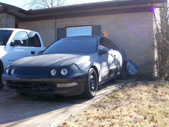

For all that dont know I bout this '97 GSR Integra from a buddy of mine with a blown block for $300.00, yeah clean title and all. Interior is perfect (or was perfect) only thing is the Exterior needs to be painted. But 300 I couldnt resist, so what to do is we just start building it.

Now for Pics
-Exterior-
