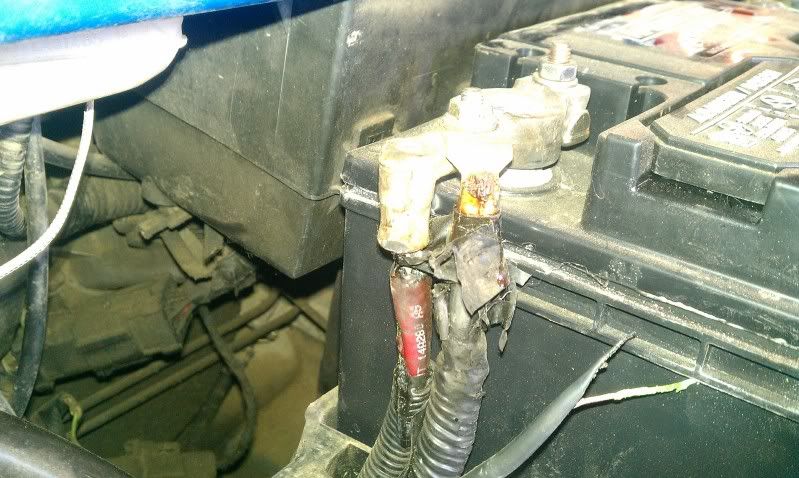

Okay so here is my problem. I recently found out I melted some power wires coming off of my battery. Does anyone know why this might have happened? We have ruled out heat from the turbo. It looks like the wires possibly got to hot internally and melted.
BACON?
3,170 Posts
Is it cranking slow? battery light on? dead battery? It looks like current was to high, which created heat melting the cable.
I would think that it would be either the starter or the alternator causing the excess current flow. Because of the fact that you did not mention any burnt fuses. The cable could have also shorted for a couple seconds, causing the melt.
look for any signs of burn near the cable routing or any visual clue's.

Well the battery is less than a year old. Cranks just fine and no battery light.
1,093 Posts
Anything replaced recently on the car: starter, alternator?
Or could be one of the battery cables lost it's insulation passing over the chasis/transaxle/block. See any burn/arcing/ melted metal near the length of the battery cables to the starter?

could have power touching ground somewhere.

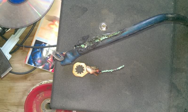

I'm starting to it was this. My fuse holder on my amp wire was broken. Also it was that wire that was the most damaged. The main power wire in only missing some of the jacket. Also mine replacing the main power wire is there away to safely repair the jacket since the wire it self is in good condition. I dont have the $90 to replace it right now.

No, there is not really a 'good' way to repair the wire jacket. Also, depending on your terminations, they might be shot as well (if there pressure terms then there most certainly compromised as the high temp made the wire expand). Per mikeeshaq, you need to get new wire and services of a hydraulic crimper if you want to make your own.

So i replaced the amp power wire and spiced in a new section of power wire for the fog lamps and didn't do a bad job soldering if I do say so my self. I even used heat shrink to keep it water tight.

So here is the cause. Amp fuse holder broke and grounded on something. You can see the burn marks in this pic.
