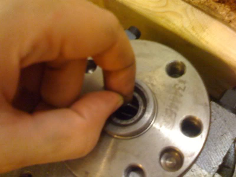

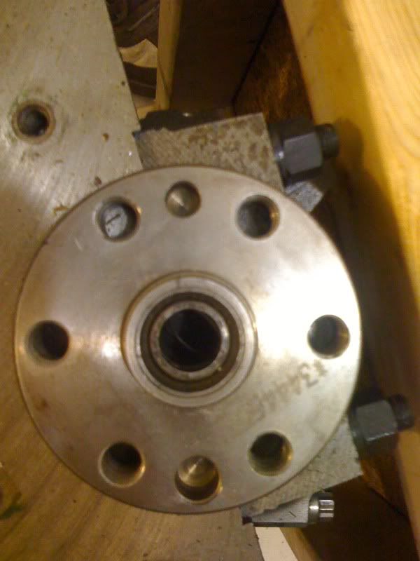

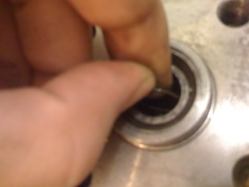

so i bought a built motor and finally brought it home from US, i have been cleaning old parts that i will reuse and when i was modifing the windage tray i noticed this washer inside the crankshaft hole where the flywheel bolts, i cannot get it out by just pulling but its completely loose inside, anyone knows what is its function and if i would need to take everything apart to reinstall it or if i can simply cut it?

Its probably a part of the pilot bearing that came off if i had to guess. I dont, remember seeing a loose washer in mine when i did my clutch. If i was you i would replace the pilot bearing just to be sure.

Even tho the Focus does not use a pilot shaft the pilot bearing is still in the end of the crank , what you have is the back side of the pipot bearing , remove it with a screw driver so it cannot make it into the clutch assy and keep going
