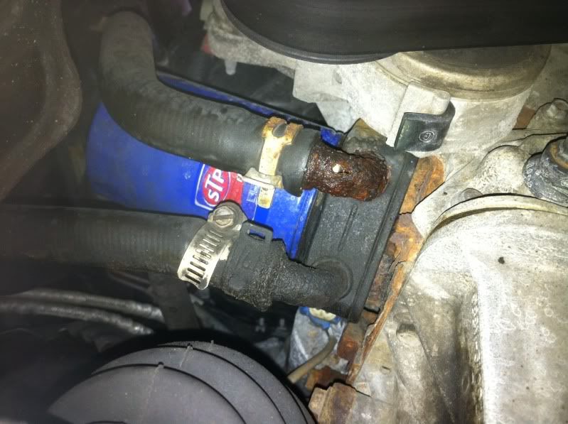

The coolant line / tube / elbow rusted through. It connects to the oil filter mount. What part do I have to get in order to get this resolved? Do I have to buy a new oil filter mount? Or do they make just those elbows?
Also do I have to get it at Ford or is it more of a universal piece that I could just pick up somewhere?

To the best of my knowledge that is the oil cooler, you cannot replace the fittings and i would contact Steve a Tousley ford for info and pricing.

What universal part can I get to replace that today or tomorrow, seeing how ford is not open and they would probably have to order it. or am I SOL?

autozone!
128 Posts
I looked on autozone, couldn't find it remember this is an svt finding parts is a pain in the butt your more than likely going to have to wait and go to ford. I believe the svt is the only one oil cooled.
The part number is YS4G-6A642-AA
stumbled upon the part number while looking at this page.
http://www.focusfanatics.com/forum/showthread.php?t=25281
