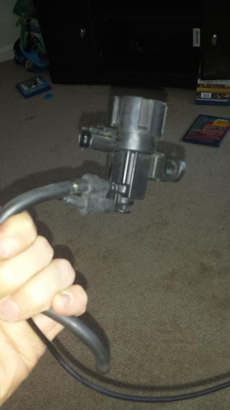

Over the last 15 months my step son and I have been working on rebuilding the engine on our 2003 Zetec ZX3, as well as doing some very basic upgrades. Well this weekend we got just about everything put back together. When all was said and done I wound up with the above part in a box and for the life of me can not remember what it is for. It is obvious it connects to the firewall. What is this thing!?!?!?!

I'd guess the "DPFE" that senses whether the EGR is working, so your guess sounds pretty accurate.

Thanks guys. We did the EGR delete when we put the new header on so I figured it was part of that system. A quick search on rockauto confirmed that it is indeed the Solenoid valve. Mikey you are correct that the DPFE is the rectangular unit. I have that unit left over also but I knew what that one was.

Hearing descriptions rather than seeing the parts doesn't help.
