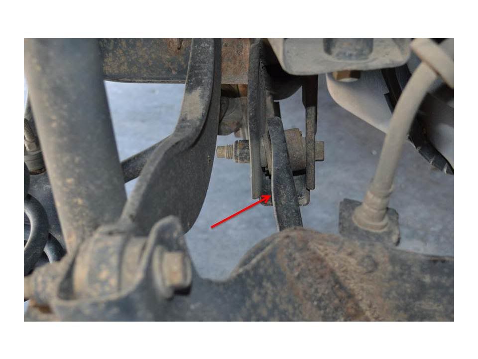

What is this for sure, it is on the rear suspension of 2006 Ford Focus. I think it is called lower control arm for rear suspension, but I am finding some parts sites saying that they carry a front and rear lower control arm for rear suspension.
Has anyone had any experience changing this? Is it hard, looks like mine is shot.

That bushing is for sure shot. Get a not so zoomed in shot and someone will chime in faster

It's called a trailing arm, but some places might call it the front rear lower control arm like you said. What exactly is wrong with it? I believe it is supposed to be twisted like that.

Technically, according to the Ford parts manual, that's a "front lower suspension arm." The lower arm that holds the spring is the "rear lower suspension arm".
Part # YS4Z-5600-DA

OH crap, I totally screwed that up. That is the lower rear control arm. The trailing arm is the one that points front to rear of the vehicle. That one goes from the outside to the center of the vehicle. I didn't realize that the rear upper control arm was in the picture until I looked at it after moving the thread.
Apparently I'm wrong again. BCZX3 has the right manual for the job.
Still- what's wrong with it?

well I wasn't sure that this was my issue, but I have squeaking noise when I go over bumps coming from the rear passenger side. I assumed that this was the culprit. I didn't take the other wheel off to see if the drivers side was the same.

Sometimes its referred to as a toe link.

Regarding the squeaks in the rear passenger side, see the post here and the other thread I link to within.
This is often an issue with a brake cable, or sometimes just needing some grease on the rear bushings.

not at all. it looks like the bushing is shot and I'm suprised you have'nt metioned your car feeling loose

I would replace both anyways for the time it takes. rockauto has them real real cheap compared to ford and their $160 crap

Well are my current ones bad for sure? Just looked at a set from CFM, not sure I want to spend that much on it. I can get the non adjustable type from MOOG about 70 bucks a piece, but I don't want to spend any money if these aren't wore out.

oh I didn't notice your post about the rock auto ones, they are a better price at about 50 bucks. What about the bolts, should I replace those as well and where would I be able to get those from?

the bolts look like they may come out. if you do have to cut them off they are about 2.50 from the dealer (in canada anyways)
