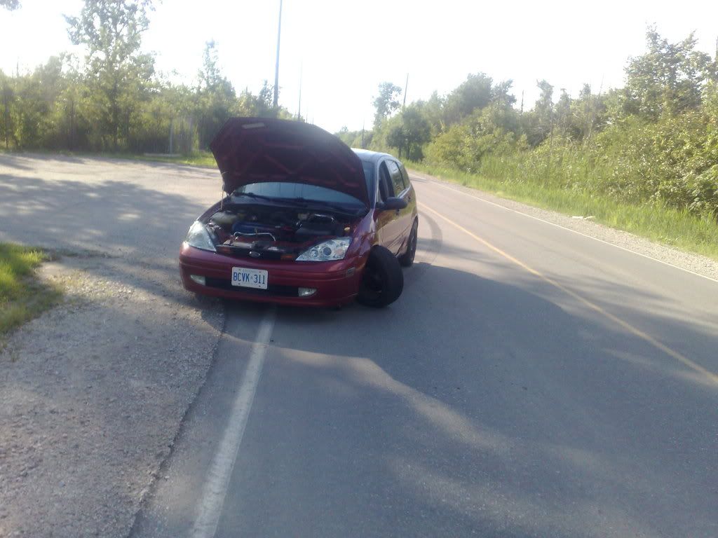

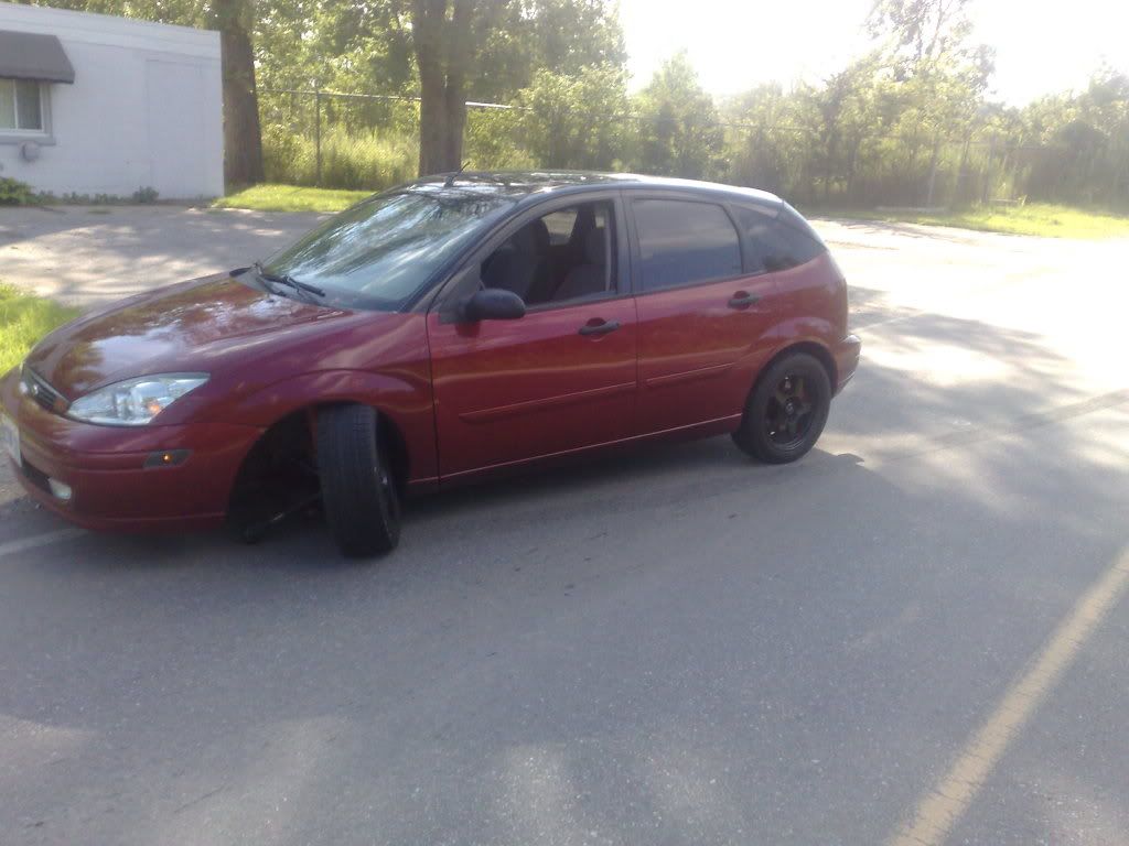

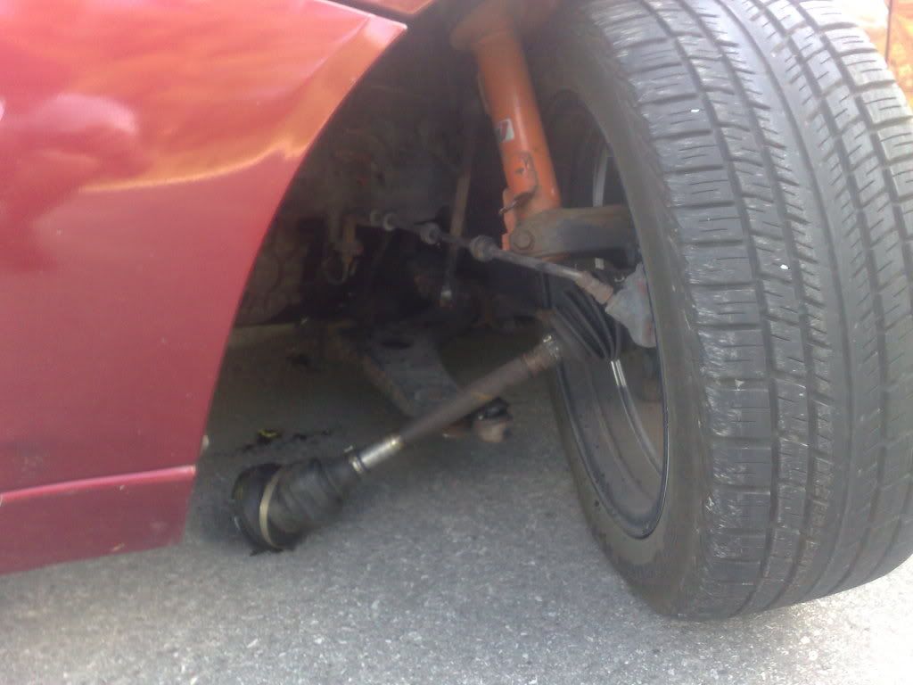

im pretty lucky with this one. earlier in the day i spent 4hrs on the highway, drove around down. then at 6pm i was heading down my street to pick up some fire wood. i heard a rumble sound after 10-20sec i went to pull off the road, when i hit the brakes and started to turn the control arm came off the knuckle.

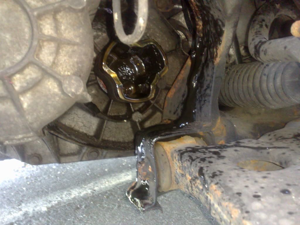

amazingly looks like a new axle and pinch bolt and the car will be good.
the shock/top plate/spring were not damaged
control arm has some scuffs and the boot tore, but ill be replacing that when i get $ for the CFM or dominent arms.
tire has some damage to the tread (from the road)
rim was scraped a bit but not much, mostly just removed power coating
tie rods good, knuckle looks fine
fender is not really damaged. the fender liner is a bit chewed from the tire but still intact.
all done by a pinch bolt that failed.

when i first saw it i thought this would be a 1k fix, but everything held up but the axle. should be up and driving tomorrow if it doesn't rain and ford stocks the bolt and napa has the axle.
i was thinking, new control arm, new fender, new axle, new tire, new tie-rod, new shock/strut

i was doing 60 when it failed, i think the rumble was the arm coming out and when i touched the brakes to slow down the torque from that pulled the assembly sideways.
at first i thought the carrier bearing took a shit, it sounded like the rumble was coming from under the passenger side (my girl friend thought it came from there too)

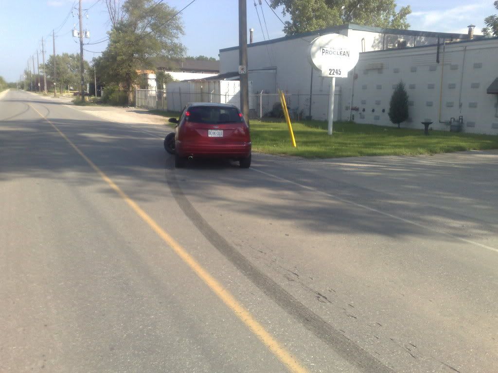

i pretty much tried keeping the car straight till i slow down enough and tried to move it towards the side of the road.
my original goal was to park in that lot (can see in the pics) and see whats up, then this happened, lol

guess being 7 years old and 250k did its toll. needless to say i'm replacing both bolts and will probably look into replacing most/all bolts on the car.

Ball joint failures are TERRFYING.
Nothing like your wheel going sideways at crusing speed.

DO THAT RUBBER BRAKE LINE, it has been stretched and is now possibly weak.
