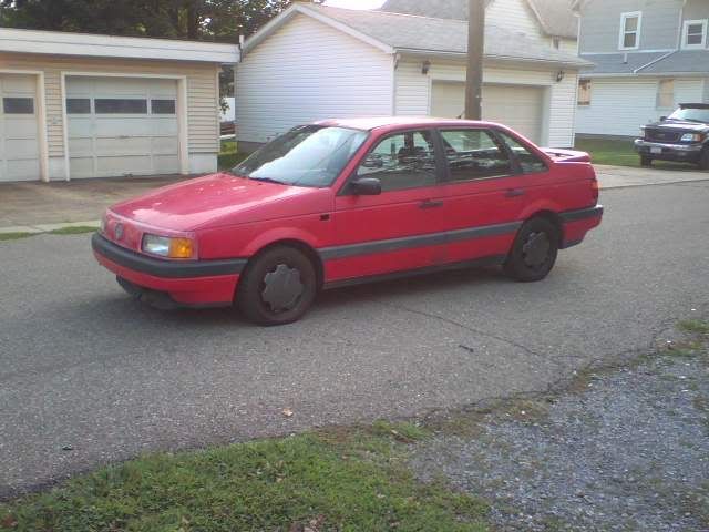

Here is the parts car, she ran great before the swap

I have the 16v pulled from the passat and the motor out of the fox and switching stuff over-- the good thing is that the blocks are the same and alot of the original parts bolt onto the new block--- Ill be sure to keep a log on what im doing to it and be sure to get some actual pictures up to keep you guys interested-----
