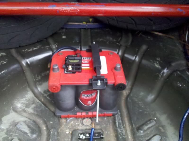

Been planning this for quite a while and after finding this thread I started acquiring materials.
Got it mostly done today. Still need some more crimps/lugs to complete the wiring and need to decide on what battery terminals to use. If anyone has any recommendations please speak up.
So this is how it sits. Camera was dead so used the phone, which recently decided to auto-focus to blurry always. I'll get better pictures when I work on it next.
Battery is mounted low and pretty darn close to between the rear wheels.
Battery is sitting in the tray that comes with the Optimas which I sheet-metel-screwed to the spare tire well. It clips into that quite nicely.
Top mount hold-down was made from a bracket I got from AutoZone and some threaded rod and nuts/washers. I'm going to be replacing the top nuts with some flange-style ones.
Got a 150-amp circuit breaker to mount in-line in the positive, hopefully it will be enough, seemed to be the largest I could find. Running 4awg wire front back, which was in place already from my audio setup.

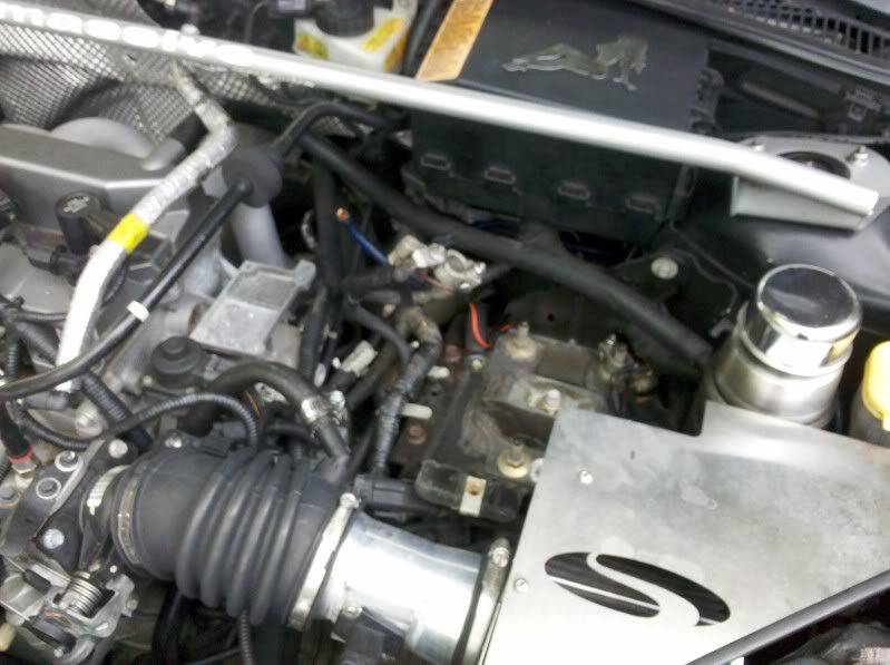

Removed the tray and whatnot, just need to figure a way to mount the original cables. Another member who did this bought some battery post isolators from a marine store that look and function awesome, however I can't seem to find any for post-style terminals just for stud-style. We'll keep looking around.

If you're not wanting to simply replace the original wires with the new ones going to the back- in order to leave the OEM under the the hood, then what you need is either a terminal block for the wires or a large enough chunk of copper.
There are terminal blocks you can get that size. There's even a groovy splice kit that is basically terminals inside a plastic case. I don't know if it's rated or 300F+ like what's under a hood should be, but I can find out the parts numbers if you want them. That would give you a disconnect point under the hood, but not a jumper cable attachment point.

No, I can't seem to come up with the right name for it but I have an idea to make one if I can't find any.

Got everything wired up and started it up tonight! Still need to go back and do some stuff for reliability but functionally its all in!
Be taking pictures tomorrow when its light out. Looks great!
