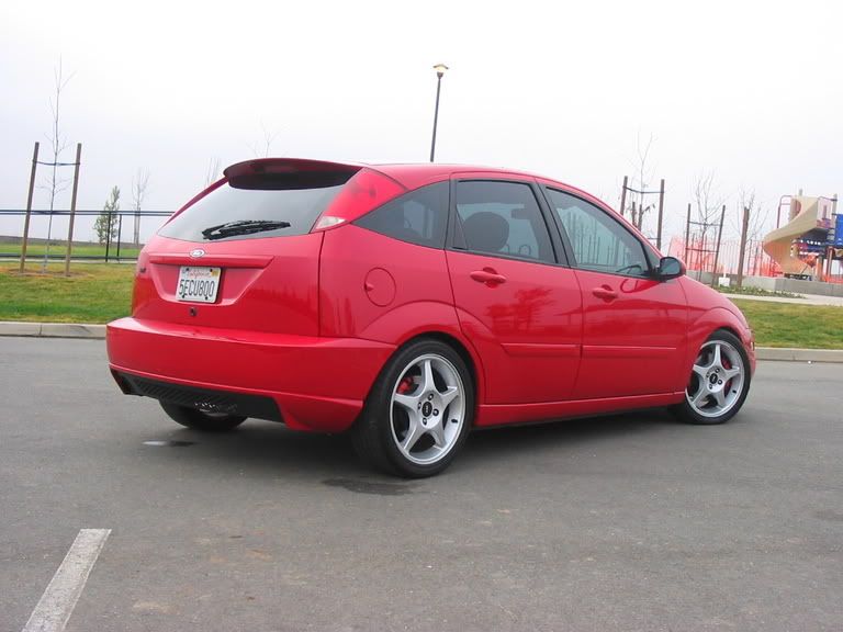

Very good daily driven set-up. Tends towards understeer, but that can be dialed out. Not that large of a drop, but great compromise of comfort and handling.
