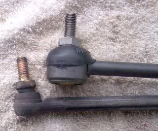

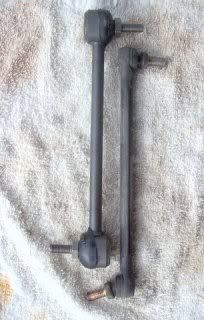

I fell victim to needing new end links on my Focus, just like so many others. I had heard a little asuspension noise for a few weeks, then I backed up in a hurry & heard a loud " clunk " from the front end. I ordered the MOOG parts from Rock Auto & put those on this morning. For those who wonder what the difference in looks is, here are some pix. Notice how worn my old one is. The MOOG part also has grease zerts , too. Drives like a new one .

I just put the moogs on as well and yeah, they were crazy bigger than the oem. Hopefully, they will last longer than the second set on oem I replaced.
