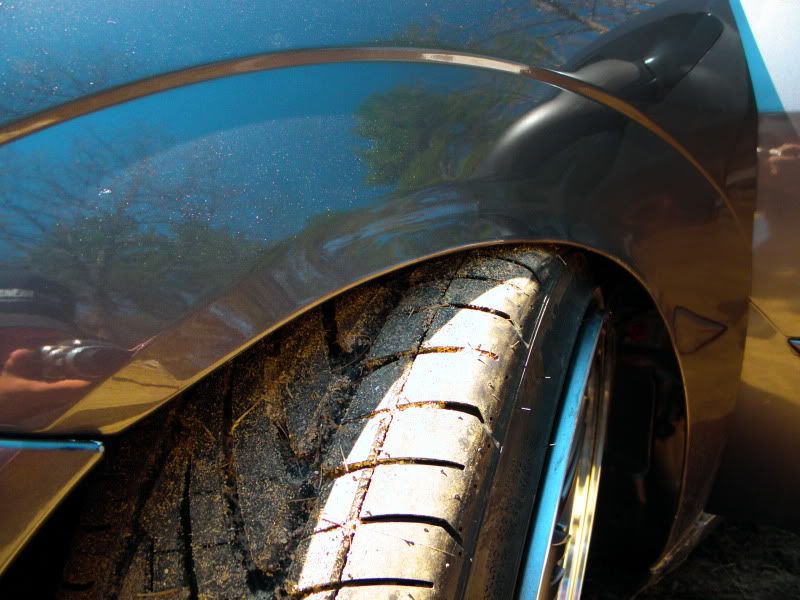

The Stretch: 205/40 on a 17x9
The car:
We rotated the tires last weekend. front is at -1.5* (natural camber) and rear is -4.5 to -6*
The rear tires had a very slight cup on the inside and the fronts were perfect... tread depth is equal the entire way across. I have been very very happy with the tires and their performance. I can drive hard and have a lot... I would recommend these tires to anyone, they were also very cheap at just $69 each...

holy stretch batman![ohcrap]
glad to see they are holding up for ya

The Neo-Gens are actually designed for just that. The inner shoulder is one continuous tread block, so it cuts down on cupping with a lot of negative camber. They're an old, tried-and-true, decently performing, low cost tire. I always recommend them to people running massive negative camber.
