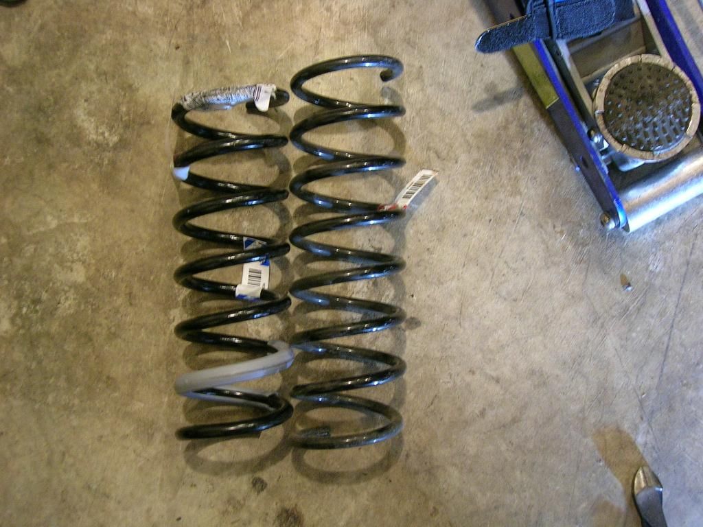

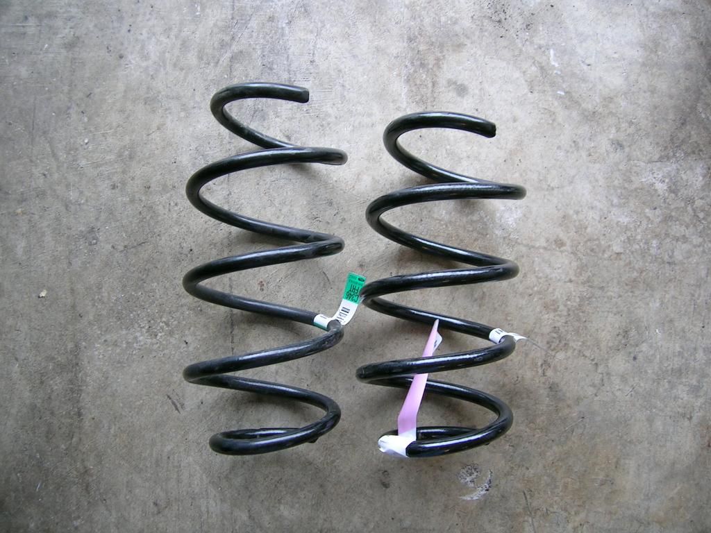

So, since I couldn't find any definitive answers on this subject (most peeps were saying that it couldn't be done), I went off of a few ideas from spring manufacturers and purchased a set of OEM Ford 2014 Focus ST springs to install on my 2014 SE Hatch. Short story: it worked! Everything bolted up and dropped down just fine. I will post pictures and other details a little later. There are year-specific parts for both cars, and a few details to keep in mind.
Just a few pictures to get started. The springs are very similar, other than about a 1-inch height difference.

If you drive a 2014, then the part numbers you need are as follows:
Front: CV6Z5310Q
Rear: CV6Z5560N
You'll need two of each. :)
The front struts will also bolt up, but the rear shocks WILL NOT FIT. The ST uses completely different rear hubs from the S/SE. You can use the handling package shocks to get closer to the right feel, or something aftermarket.

It lowers the car a tad, but it's pretty negligible. Nothing like typical lowering springs from Steeda, Eibach or the like. It does improve the handling (roll stiffness is the most obvious) but retains a nice ride. To those who have owned Mk1/2 Foci, this is very much like going from stock to SVT springs.
