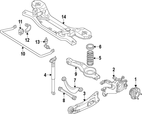

so i did some of my own research just now and not 100% sure if i'm correct, but pretty sure i am. (IF THERE IS ANYTHING THAT SHOULD BE ADDED/REMOVED PLEASE DO NOT HESITATE TO LET ME KNOW, this is my first time figuring something like this out)
I compared the part numbers for the 2015 ST and 2015 SE struts to see if ST lowering springs would be a direct fit on the SE and they appear to be.

the only problem with ST springs is that the drop is meant for the ST focus which weighs more so it might not be the exact same drop on the NA MK3.
357 Posts
correct, so the height may be lower or higher than intended for the non ST models, but they fit directly without having to swap any parts.
