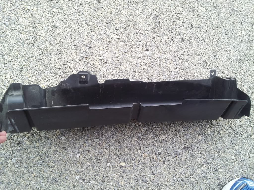

Not sure why the piece I took out looks different but it could be because I have a 3/11 build date.
Here are some more photos.

You do know that you just removed a crucial part of the cooling system right?...just saying your radiator now has terrible airflow.
Now, removing the snorkel on the airbox and the air horn is a GREAT mod..that is what I have done

I don't think this mod is really going to have a negative effect on the radiators air flow as it gets most of its air from the bottom.

So here anyone knows whats the exact use of that snorkel ?
^^^This. And it is literally in front of the car getting forced through the air.
I'm sure that the snorkel design is probably due to nvh/fit and finish.

Sorry for stealing your image jdubhack I just wanted to clarify..
Is this the flap that gets cuts? Can't this top part just the remove apart from the bottom??
