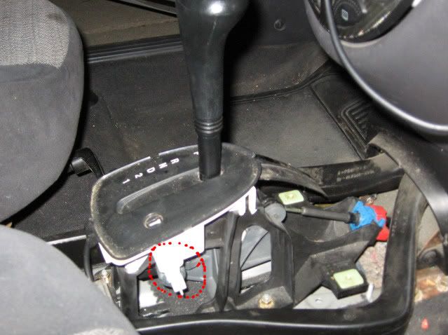

My shifter will not unlock because the button won't depress when I press it. I removed the console and found that when I press on that selenoid inside the shifter it unlocks. I pryed off the little cap and now push down in the exposed slot with a screwdriver to unlock my shifter from park. My key won't come out of the ignition either??? Has anybody encountered this problem or know any solutions?

I can't tell you the exact reason, but it's related to the key being stuck in the ignition. I know this for sure.

You get this fixed? If not, you need a whole new shifter, you just can't buy the solenoid. Get a used one. This was one of those things that pissed me off about the Focus, stuff that breaks down on these cars but never on any other car I have owned.
