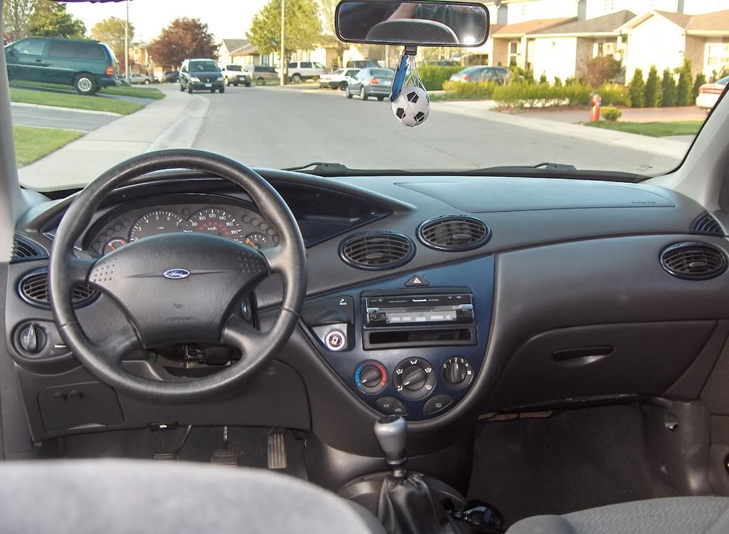

so i got kinda bored the last few days so i decided to paint a bunch of stuff i hope you like
BEFORE:

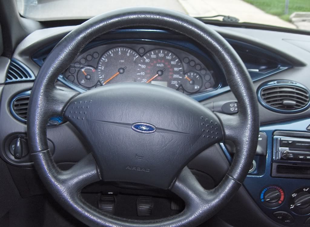

AFTER:

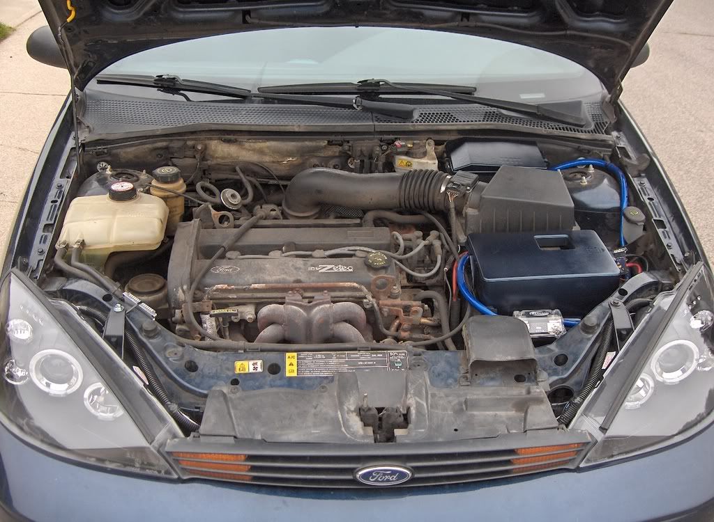

engine stuff:
HELP ME CLEAN MY ENGINE!!!!!!!!

Hope you guys enjoy please help me clean my engine bay and make it purdy
nice dude, the repainted stuff looks WAY better. For your bay, you should paint your valve cover and get the blue steeda intake. My friend has it and it makes his bay look SOOOO much better

forget upgrades under the hood just CLEAN it.... on man that just blew me away how filthy it is... the rest of the car looks good but still...
1,653 Posts
Definitely looks good, except the engine bay of course, and thats nothing a few cleanup supplies and a small hurricane couldn't fix.

LMFAO ...well what do you guys recommend i use to clean it...when i bought it was worse acuallyi used gunk on it but made my car REAK of oil and grease just awful smell.......give me any ideas i dont care what to make it look nice and clean specially cause i wanna enter shows with it

i can just put a hose in there i dont have to cover anything????

you can...get everything wet and then spray the whole thing down with degreaser( Castrol Super Clean or Purple Power...Walmart) It says to mix it with water but dont, spray it as is but dont get it on your skin, it will peel off. Let it sit for 5 minutes and then start the engine. With the engine running spray out your engine bay. Everything could get wet but avoid direct spraying of the alternator, wiring, etc.

Monkey if you wanted to clean up your engine bay we could have worked something out for the Ford Racing Valve Cover and the Black Degass Cover (rad resvouir) and you can paint that blue to, let me know maybe I can get them together with the knobs ill be shipping them out 2morrow im glad you like the headliner and it's great you were able to match the fronts. pillars to the already painted rears as for an engine wash i would cover the alternator with a plastic bag just incase u get water to close to it.

for all the paints i used duplicolour. the dash pieaces are ford shadow blue.... the engine bay is ford dark blue, and the black was plasic and fabric paint.....then i used an SUV top clear coat for it all to make it nice and hard
