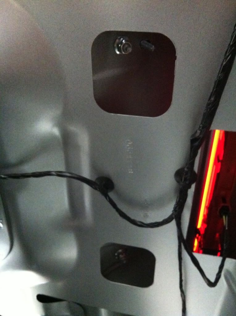

Trying to figure out how to get to the rear Ford badge. There are no screws directly behind it (like I expected) but these photos show the closest screws to it. My only concern is that there are identical screws like this around the trunk panel that make me think they have nothing to do w/ the badge. Any help would be appreciated!

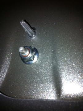

This is my only other thought on how to get to the badge.

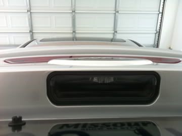

to have a "shaved" look. It's common practice to do on the Volkswagen Golf especially.
like so
before
after
If it's anything like the VW emblem, you will need to mold it and repaint it. It's definitely a future mod I would look to do on my Focus.

I don't know for sure but I just took my Ford badge off on my first gen Focus today and it is just a glue on. My guess is that you badge is the same and all you have to do is get behind it with a screw driver and it should come right off without damaging the badge. I have already had mine on and off a couple times and those badges are durable.

figured the posts were like a guide to make sure you put it back on straight. maybe the person who had the car before me just glued it back on instead of screwing it on. when i pulled it off there was nothing holding the posts onto the car.

Most all emblems these days are held on with double sided foam tape. Warm it up with a hair dryer and use a piece of nylon fish line to slice the foam. Goof Off works great to remove the remains of the foam and adhesive.
