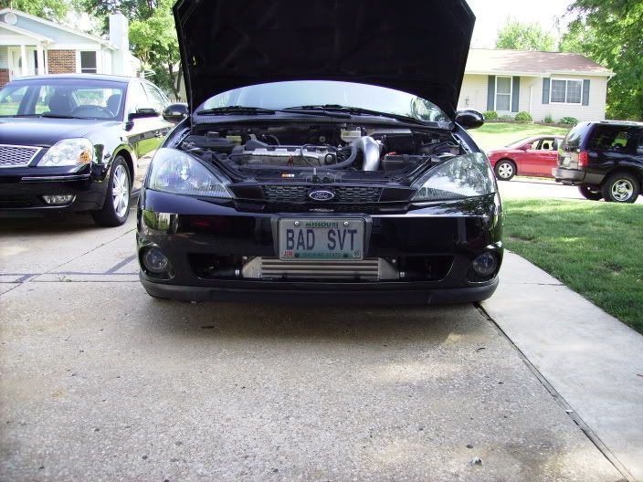

Here is just a couple of the many pics I took during install. I changed the piping around a few times, so I will post up more pics soon.
Edit: The intercooler is a Precision Turbo & Engine 26.5x6.2x3.5, PN AS-1021. Picked it up for $220 and had it at my door the next day. When I got my Procharger they sent me the wrong tubing and I had to get the right tubing sent to me, so I had a lot of extra lying around. I used mostly that, but alot of the tubing is soft, so I will probably have a shop bend me some hard pipes eventually. As you can see in the pics the only way the intercooler is mounted is with some custom brackets out of 1/4" x 1" flat stock. Just drilled some holes and it is mounted to the front bumper support. It is very solid and isnt going anywhere. I went through aobut 3 or 4 different setups for the piping, evertime I did it I would go to put the bumper on and it would hit the foglights. So the pics arent the final setup, except the last one which you cant see the piping. The only tube I had to cut was the one with the Bypass Valve on it, so I could remount it, it is on the opposite side of the intercooler now.

Well, right now I am just running a base tune from Wayne, and it isnt running quite right as of right now. So after I get the 15 lb pulley on it, more than likely this weekend, I will have it dyno tuned so I know that it is running right and safe.

That pic just looks incredibly sexy. I love it!

I like that in that pic you can see all three black Fords my family drives. The 500 is my moms, and the exploder is my dads daily driver.
