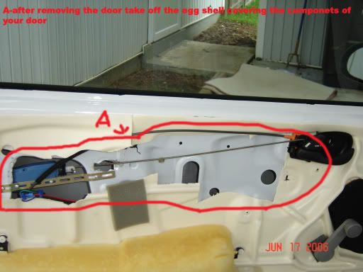

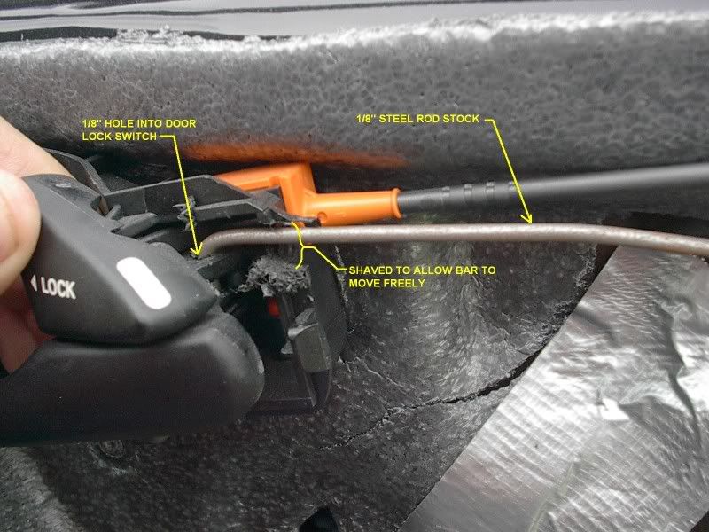

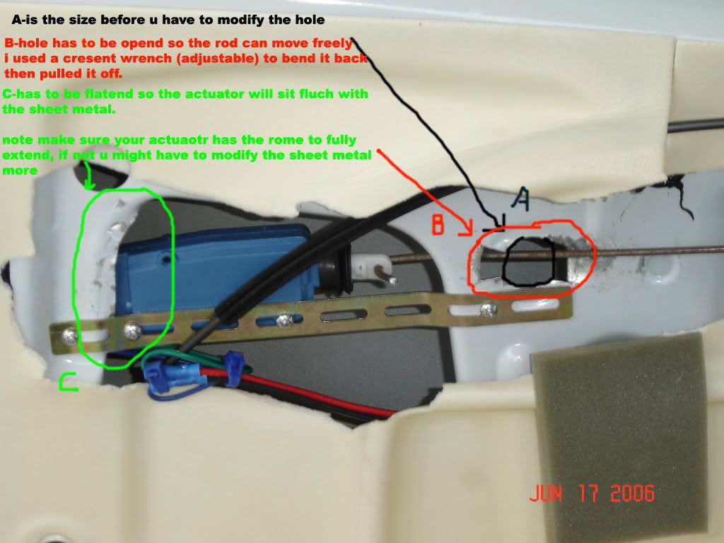

heres a quick write-up with the pictures i have, after u do all of that just bend the rod ends at 90 degree angles and insert them into the lock and end of the actuator. on the actuator end u will need to curve it a bit to make sure it doesnt come out of the hole. the other end should stay put i have not had any problems. if u have more question u know how to get a hold of me. hope this helps you guys
