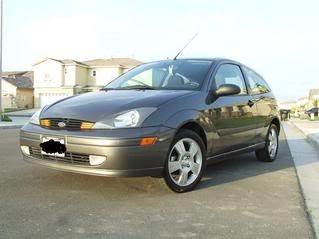

Here is my 03 Duratec as it is now.

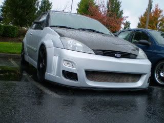

My car is pure stock and now that I have decent income to save for parts. I wanted to ask the community for ideas on what I should do on my car. I am not looking to go extreme I just want something where is can occasionally go autocross, drag, and Canyon driving, but also be my daily driver. I do have over a 103k miles on it as well and also wanted to mention that it is automatic. Exterior wise I was thinking of a this kit

Don;t use that F2 bodykit get an OEM Ford ones fromm here or Europe.

car looks sweet!

personal fan of the F2 RS widebody kit, however crappy it may be...the real fenders are no longer available from Ford...but the SVT is the next best way to go

the f2 kit is terrible, it hardly ever fits right, it is of very very low quality and honestly its big and bulky and doesnt make a lot of sense on a street car that sees track time.
you would be better off with an SVT kit, ST170 bumpers or making the best of what you have. headlights, grilles, tint, wheels, etc...remember with wheels tho you want a 16x7 wheel with a good contact patch for auto-xing and canyons.

A European bodykit will yield the best ground clearance out of anything else, since the bumpers are actually shorter. This will require some modifications to the crash bar that sits behind the bumper covers and is typically the most expensive option, but it's the best in my book.
