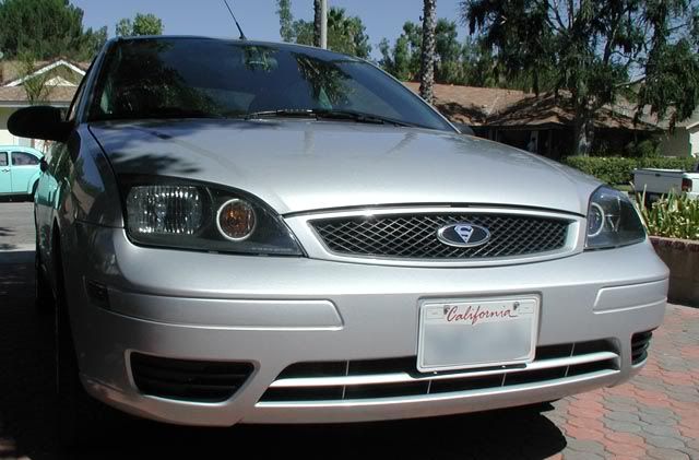

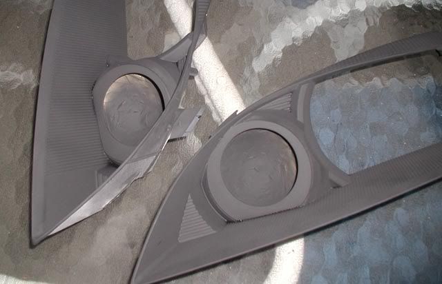

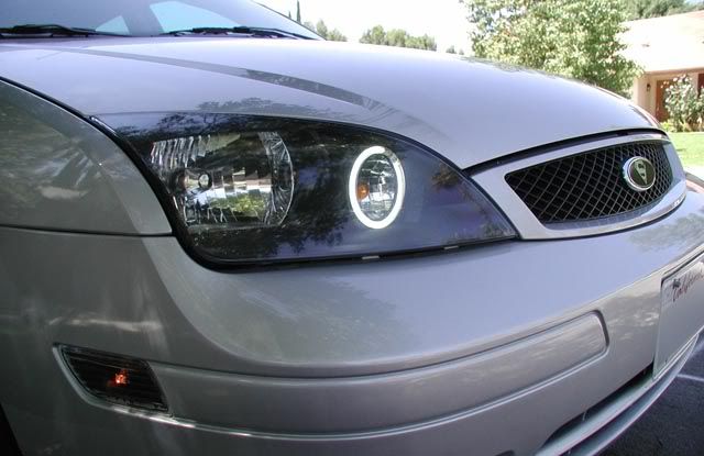

Finally got around to doing mine. Decided to go a little different. I bought one of those angel eye kits off ebay for like $40, but only ended up using the smaller of the two. Might use the larger ones for brake lights? Anyway, I made some mounts out of abs plastic, glued them on, used some body filler to smooth it out then painted. I wired the angel eyes to the running lights so the amber light stays off until I hit the turn signal. I have some silver bulbs on the way, hopefully get rid of that egg look. If not Ill do with LEDs. Im pretty pleased with the results, let me know what you think.
Mounts
In the housing
Glued and filler added
Primed
Painted and angel eye installed
Comparison of new and old lights
Installed in car
Angel eye on

that is nice as heck i wish i had time to do that.. nice job i like the halo's were did you pick those up at?

Very well done, they look very nice with the eyes.

DAMN!!! And I thought that by painting the inside of my housings black it would make my headlights look the best they could ever look, now this? Looks awesome by the way, great job!

I have to say, the painted headlights alone may be enough to get me to come around on the 05+ front ends. Nicely done.

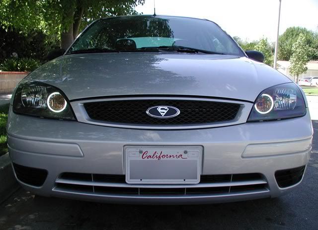

mmmkay, got some new pictures. I recieved the reflective looking signal bulbs today. Huge improvement I must say. I still may do led bulbs down the line, but for $4 each, Im happy with these ones.
and some night shots, convinced my loving and supportive girlfriend to pose for me
I thought this picture just looked neat, cant even tell their halos tho [8]
Getting decent night pictures sucked too.

why did you not do the other halo in the main headlamp?
Looks good though.
