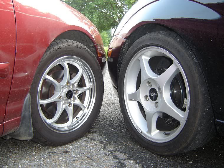

so me and a friend decided to stop waiting to paint our brake calipers and rear drums...so we went out and bought primer and black caliper spray. DAMN does it look awesome! splitting to cost was a total of $10 and well worth the looks. i will have pics posted as soon as we hook my camera up to his laptop.
this also makes the cross drilled and grooved rotors look even better haha

oh yeah, 2 coats of primer, 3 coats of paint on front disk, and 2 on back drums

steves a lil gheeeey. don't mind him. i'm jim. i decided to join for hte hell of it. (since i'm part of 10 or so forums as it is). i'm rather happy with the results of our lil endevor. only thing i need to do is go back over that bracket that sits infront of the calipers then it'll look a little better.
