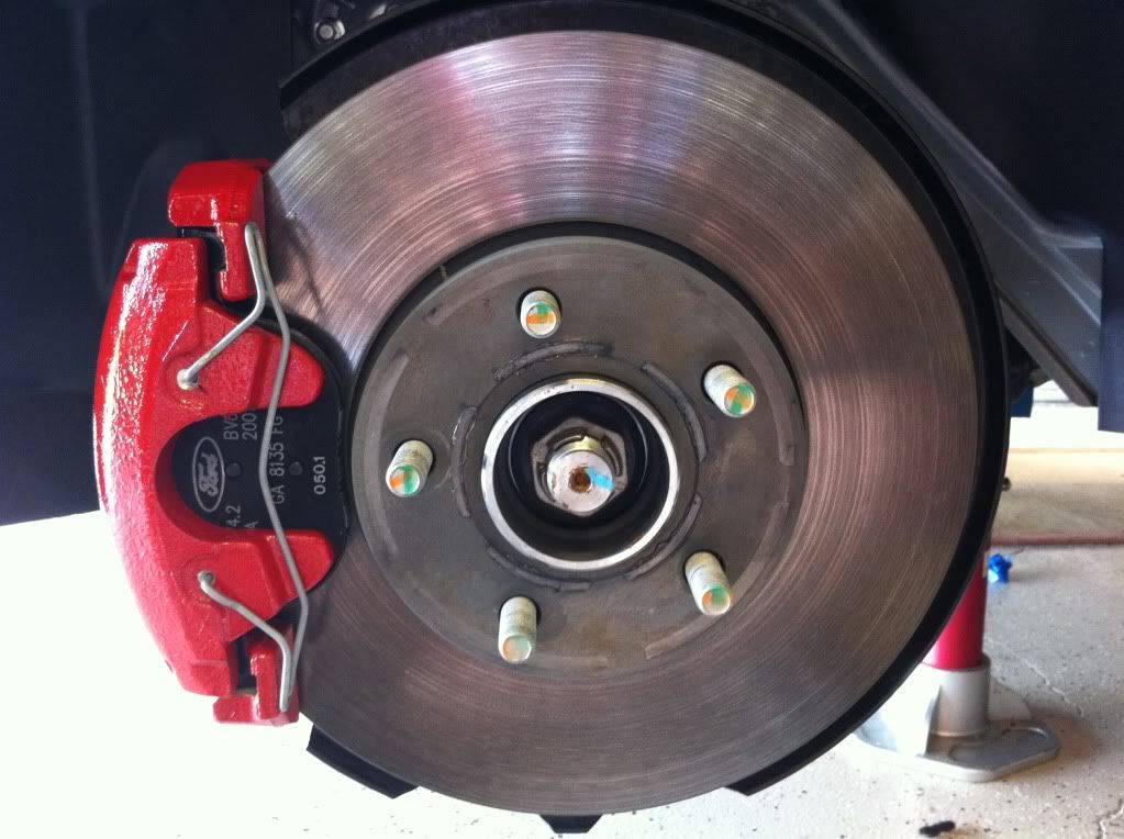

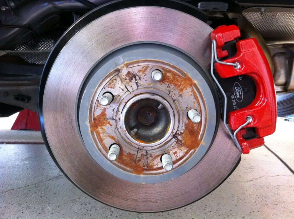

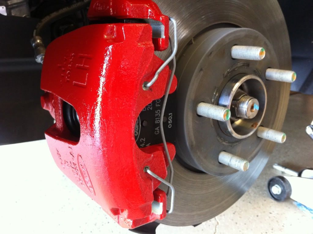

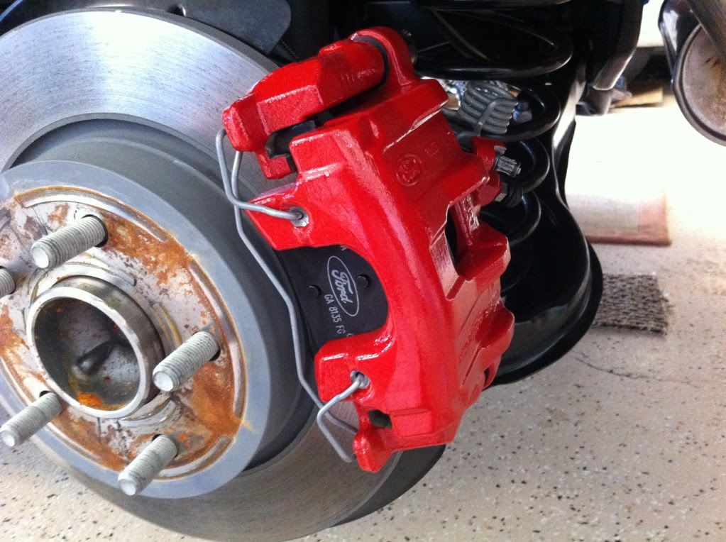

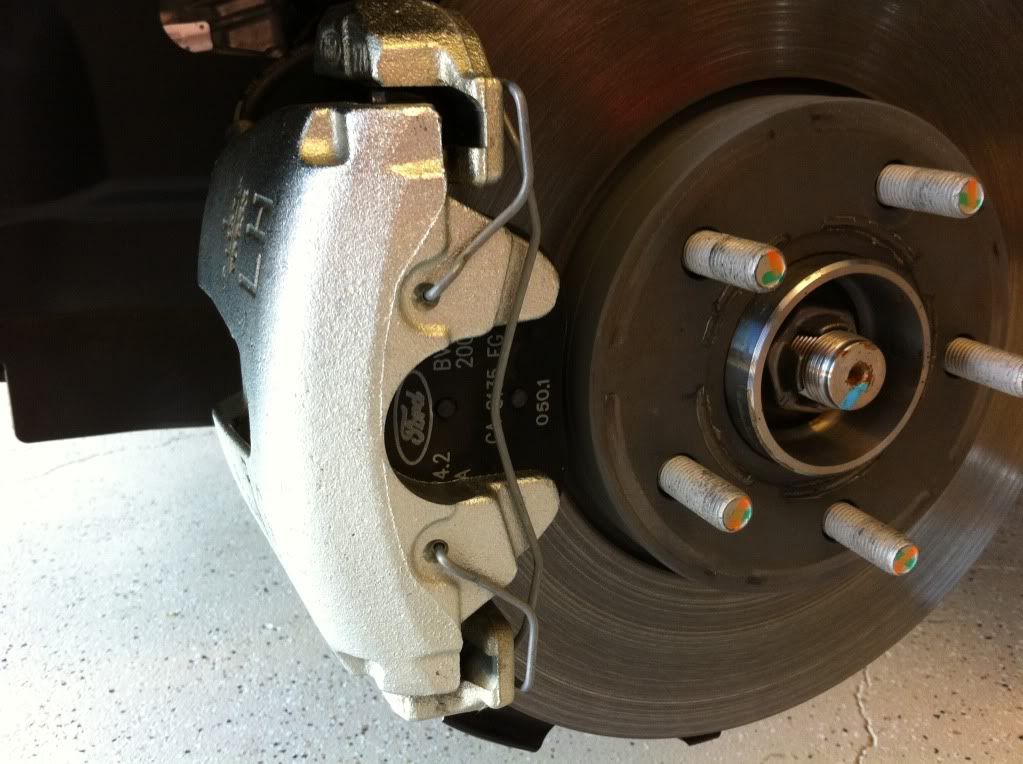

Well, I ordered the G2 Caliper Kit in red and prepped the car last night. Got up early this morning and mixed the epoxy and painted for three hours. [?|]
Pretty satisfied with the kit overall....since it is an EPOXY it starts to get very sticky after 2-3 hours. It was close to 90 degrees in my garage when I painted them so it set up a little faster than normal. Just lots of detail to paint around even though I taped alot of it off ahead of time.
I'll try and take some photos with the wheels on tomorrow.....but you get the idea.
FRONT: Before.....
FRONT: After......

REAR: After......

Wow, that is really good. You painted those as they sit?
No, no......I did take them apart like you would to put a new set of pads on.
I didn't take them off the car......just took out the pads so I could turn them and get them painted. I basically got some strong twine and tied them up in the air from the springs so I could manipulate them to get all the paint on them.....let them dry and then I re-assembled them.
BUT.....taking them completely off the car would be ALOT easier to paint! This took alot of laying on my back and twisting inside the fender well for three hours. Just didn't feel like bleeding all the brakes and all.
