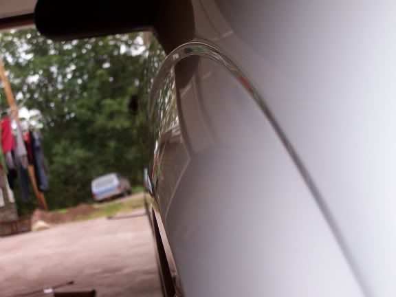

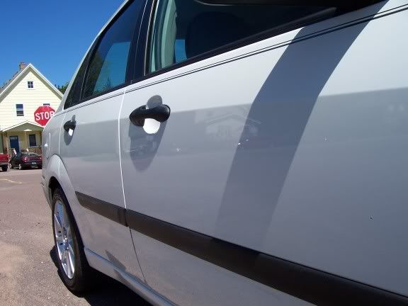

ok so this is a informative thread i want to make on what products you used, and what order you used to get that OOO SO SEXAY shine out of your car
so hers what you do, wash/wax/claybar/detail
do any of the following and then do a small right up
i have never done clay barring and would like to know some ways in which to get a awesome shine that looks great
so ill start it off
Mr. Clean car wash
soaped, then with a big sponged washed it, then used rinse mode, then i used that misting feature for autodry
then i used meguirs classic and got this fantastic shine out of my car
o cover your eyes![:D]
and
now its your turn, help me and help others get a great shine out of their car!

yeah, i used Megiuars Gold class wash, with a soft brush for the body/windows, and a stiff brush for the wheels. Washed and rinsed each section of the car three times. Sprayed on wheel cleaner, and scrubbed each one with a toothbrush. Used chrome polish for the tailpipe. Mothers Cali Gold claybar kit. Megiuars Gold Class past wax, then some sealer (dont remember the brand), and then some ICE wax as a weekly detailer. Also put rain-X on the windows. Dusted the interior with Armor-all wipes, cleaned all the windows with Stoners. And went through the interior seams/crevices with some detailing brushes.
my car looks like black glass. well, except the scars on my front lip from curbs.
I just drove through a storm earlier, the water was sheeting off my car.
