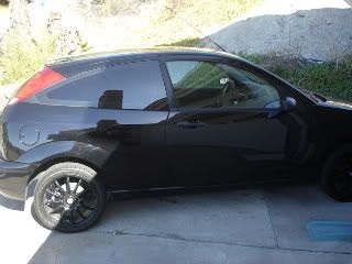

New to this forum, seems to be a wealth of knowledge to be had here. Im coming from having a 93 prelude i hated and drove into the ground to recently purchasing this 05 black beauty im looking to baby the hell out of.
Yes I know she needs a drop horribly badly, ideas that will best run on my TD 17s? And what tire does everyone out there run on TDs.

I think im just not accustomed to the low pros is the thing, ive also never heard of nexen tires. Bought the car at a reputable dealership after looking extensively and was amazed to see the Team Dynamics, no scratches or road rash to be found yet.

Hey I've got a set of 17" TDs too, 215/45r17 tires were my choice. I've got an Eibach prokit drop and the fenders hug the tires nicely, and I only had one rear fender rub a little, but that was easily fixed with a little gentle fender rolling. I went for the 215/45's because its the stock svt tire size and I wanted the extra cushion of a 45 series tire.
Heres a few pics for reference... Hope they help your decision![thumb]

If you go with a drop of more than 1.5" or so you might rub with 215/45 depending on your wheel offset (I'd say <42mm) and how hard you drive. Personally I use 215/40 on a mild drop, but it's because it's closer to the stock tire size, smaller, and I autocross so there's lots of hard cornering. Keep in mind though that the roads aren't that bad where I'm from and I also keep them inflated a little on the high side on a reinforced sidewall tire haha. I imagine the 45 fills the fender gap a little more though, mine is a little wide.

I want to post pics once its lowered, but imma do a full wash and prolly take some night shots for you.
Im gonna do a mild drop, thinkin the FRPP 1.5 will work well for my needs and likes.
