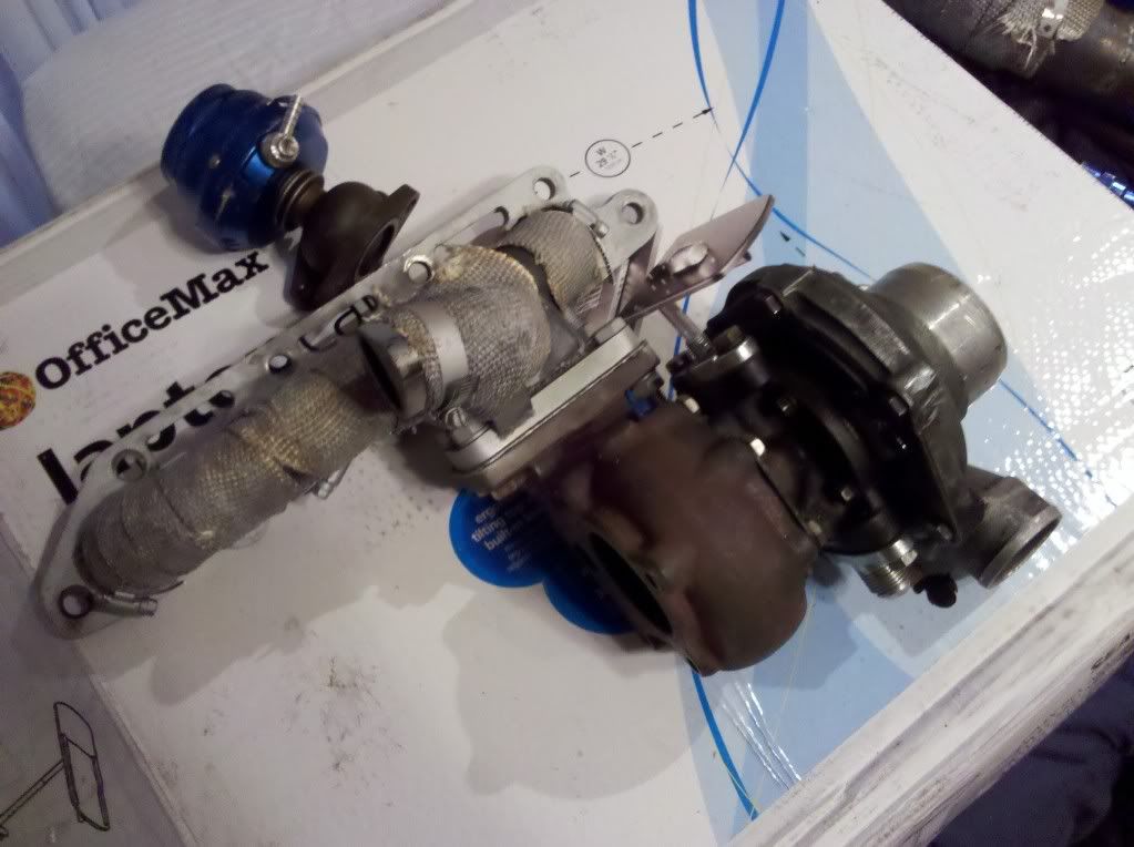

Well after switching back and forth between my Rx7 and my escort, I had finally come to the conclusion that I will need MASSIVE amounts of money to even get my rx7 up and running where I want it to be so I switched back to my escort for now. So the Boost has arrived, I ordered a partial turbo kit from Underclassmen (aaron). now I am working on turning that into a full kit here is the manifold and turbo!

here is the layout im thinking about if i can clock the turbo down:
