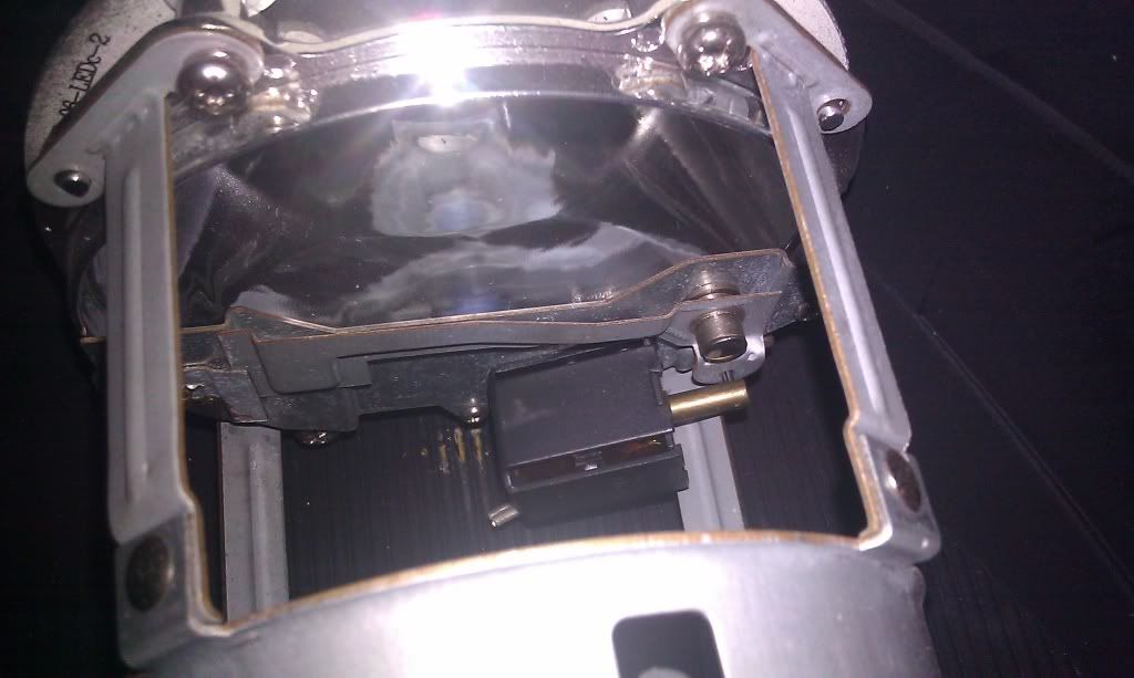

I need some help getting my HIDs properly aligned. As you can see form the pics below the drivers side output looks more like a V. I know how they are supposed to look, I just need some help getting them there. Any ideas?
I can easily provide more pics if needed ;) Thanks for the help as always guys

ive never seen that cutoff used for HIDs, i thought that was a halogen only projector.
either way, you need to twist the cutoff plate to level, and if you cant do that, you need to remount the projector so the output is level. Its a PITA, but its the only way.

Ok I will give that a shot then. I have no idea what they guy used. It was a retrofit from one of the old vendors here. I am saving up for a new suspension for my svt, then probably next fall I cam get new headlights. I want to retro fit a set of blacked out Machs. All the hid parts will come from TRR. Until then I need to make these work.

looks like a European slope projector. have a couple friends with euro ebay projectors and this is sloped like such.
