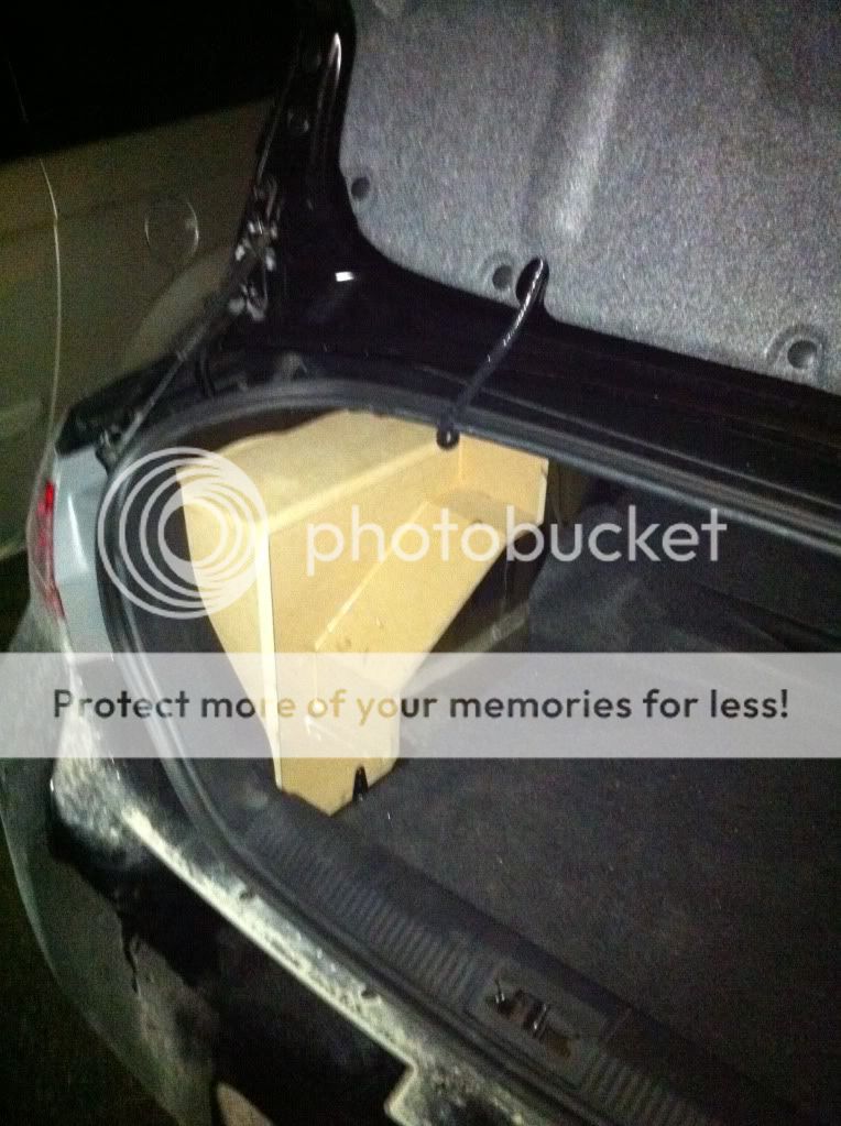

since i havent found a prefabbed sub box that fits my 08 i decided to venture out to the shop and build my own. first test fit and it looks pretty friggin good IMO..
ill be finishing up the face of the box and finalize the mounting today, also need to run into town to get the carpeting.

yep. my car has the moon n tune package but the sub just isnt cutting it. dont get me wrong not bad, but not good. theres going to be a 10" MTX Thunder 5500 going in there. and i will get more pics up later as more work gets done.

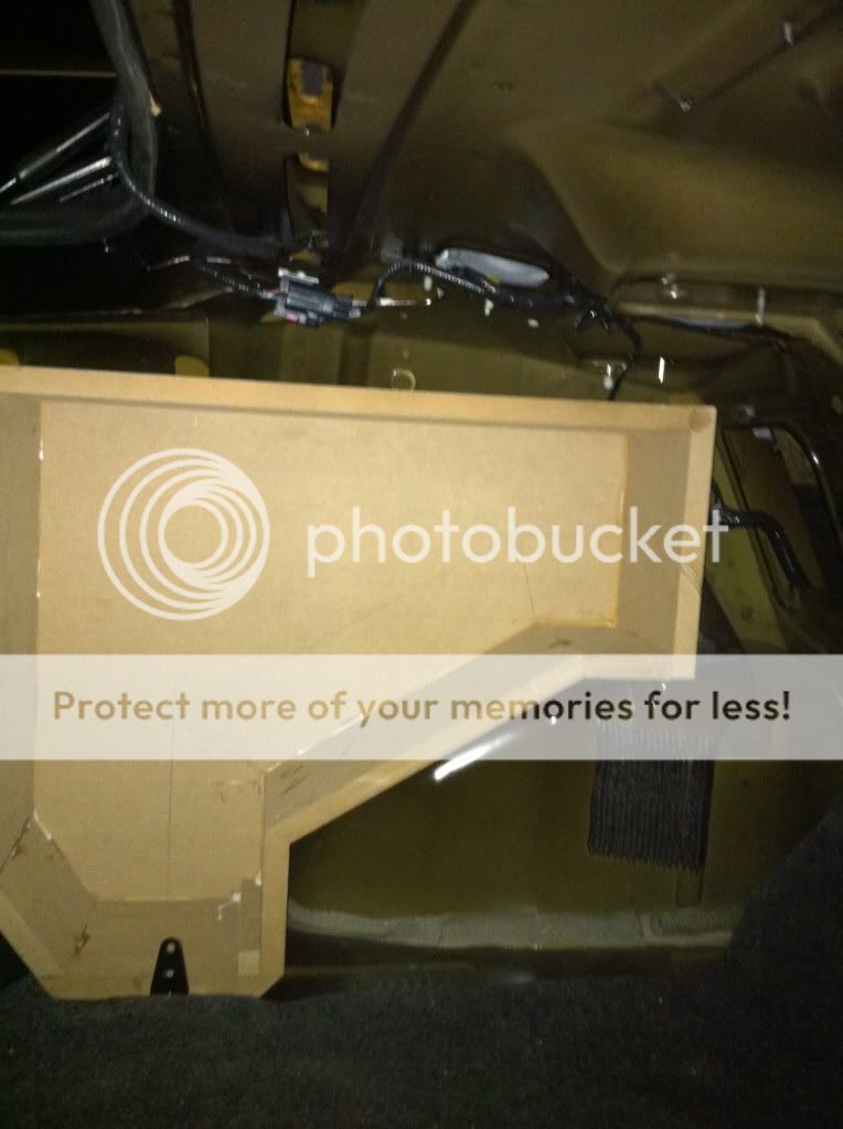

this is the bracket that i had to fashion up. It uses the factory bolt holes for the stock sub, and it fits like a glove.
installed
this the bottom bracket (nothing special, but very important)
box with panel blocks, pre carpet
last test fit, pre carpet
post carpet and final check.
