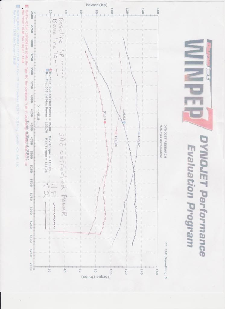

^this was w/o 'tuning' cam gears, and without early 2000 Intake Manifold that makes 5hp/tq on a stock focus.
Its been ported to fit a 65mm TB.
So as ray at mcnews told me the IM was the 'bottleneck' in my engines breathing.
This mod made a REAL nice difference and should gain atleast 8 hp/tq with all the other mods.
Placing it squarely at 140 hp + 145 tq at the wheels.
Plus a 55 shot will put me right around 200 hp/tq at the wheels.

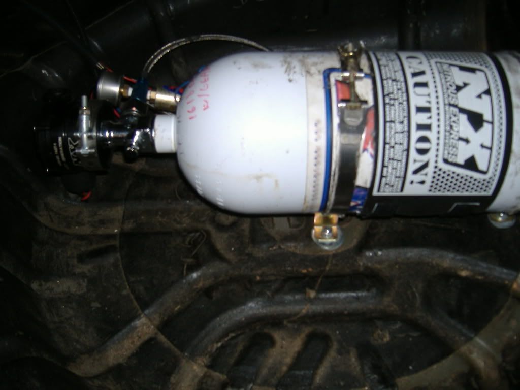

NX nitrous kit(thank you Bill)
NX bottle heater
NX remote bottle opener

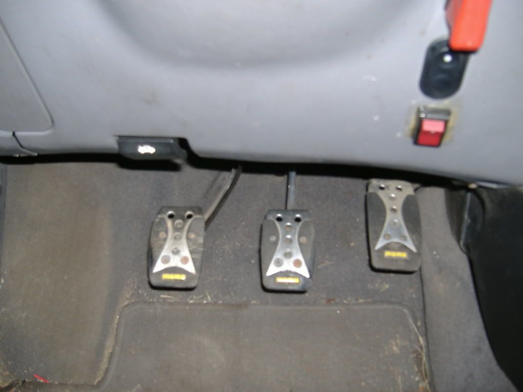

MOMO pedals

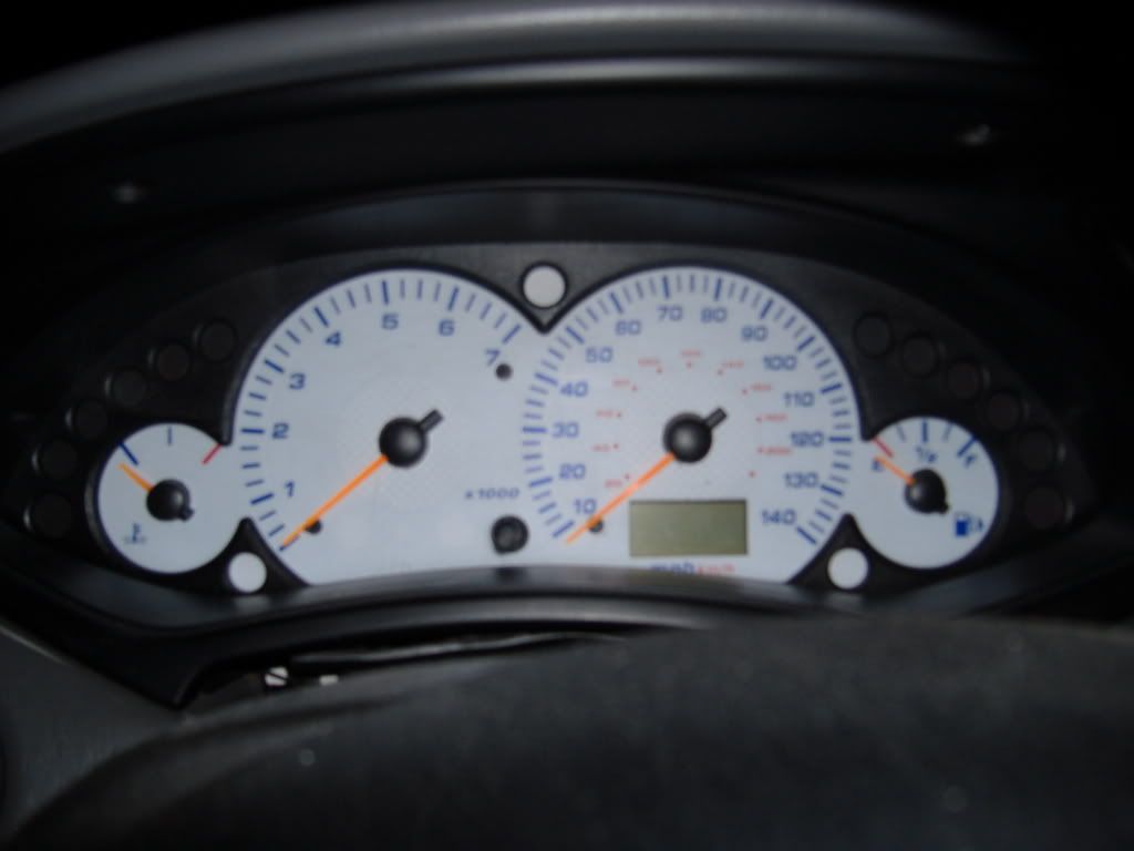

WHite faced gauges
