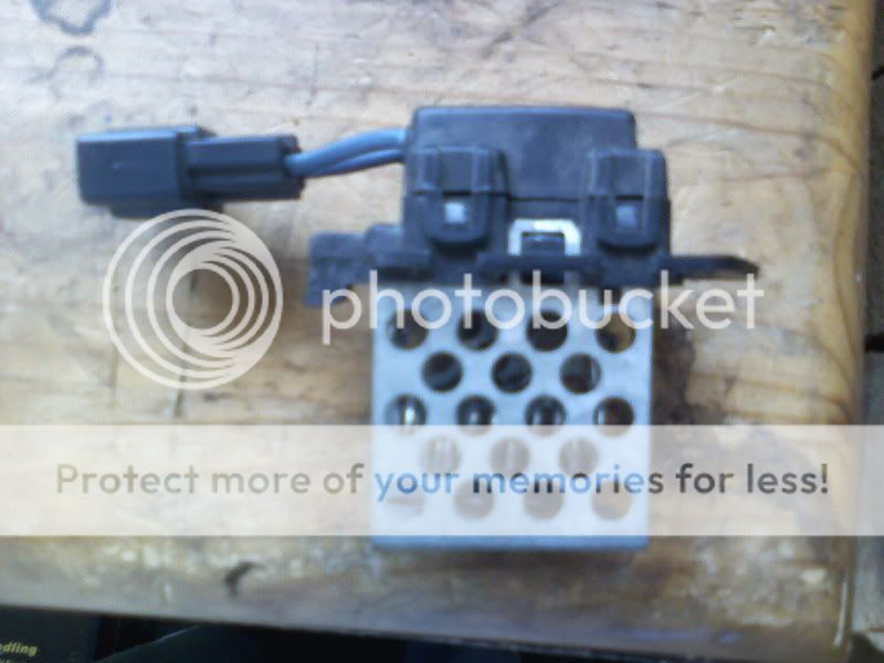

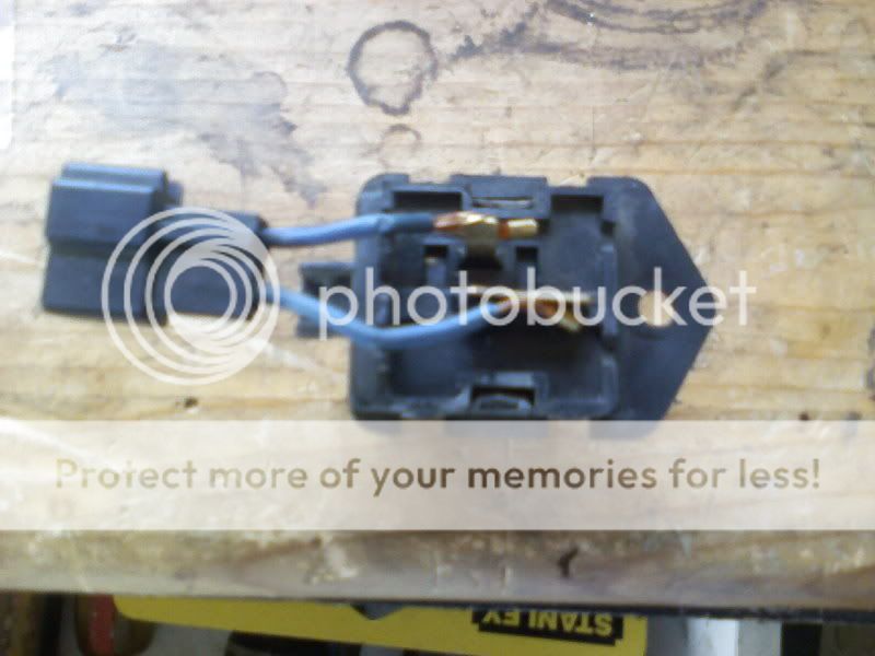

when it's at idle, stop and go trafiic, I rises to the red zone, I think is the resistor pack, Went to ford dealer and they don't have the exact replacement, here are the pics of the resistor pack:
Does anyone have the same resistor pack? part # or any info? thanks for your help.

Check the thermostat housing, they are quite renown for going out in focus's. From the pic the resistor doesnt looked burnt up or anything...but pic to actuality is night and day. If it is the thermostat housing you might as well replace the thermostat as well. Is coolant leaking any where by chance?

Had the exact same problem. Most of the time the resistor pack goes out. More importantly is the wiring pigtail that connects to it. Mine was completely melted and corroded. Go to ford and purchase a new resistor and the wiring connector for it. They should know what you're talking about. Just cut off the old plug and use the crimp connectors to connect the new one. Good as new.
