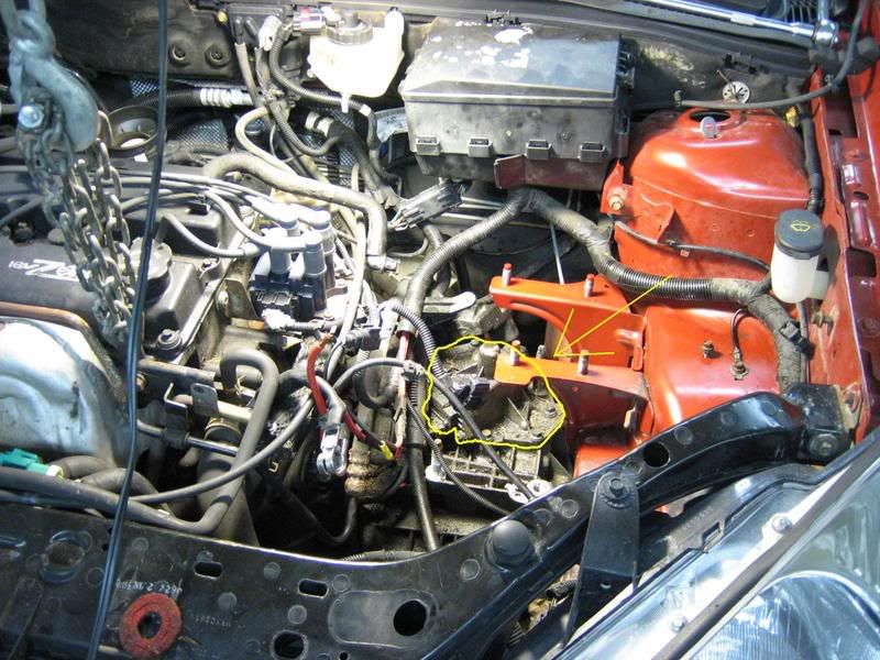

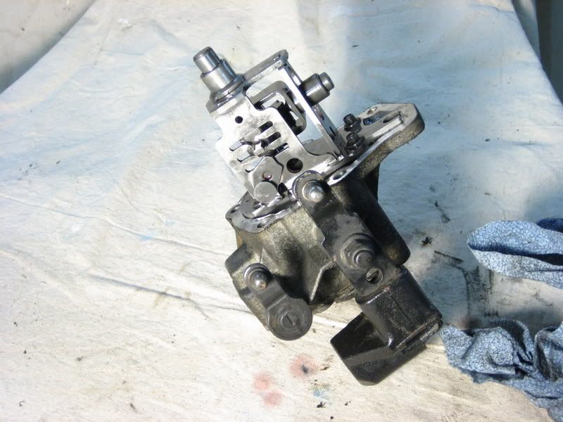

So earlier when I introduced my self to this forum I mentioned I had a MTX-75 5-speed trans that was stuck in first. I was going to pull the trans and inspect it. I removed the "box" that the shifter linkage connects to. I think I may have found my problem.
Maybe you guys can help.

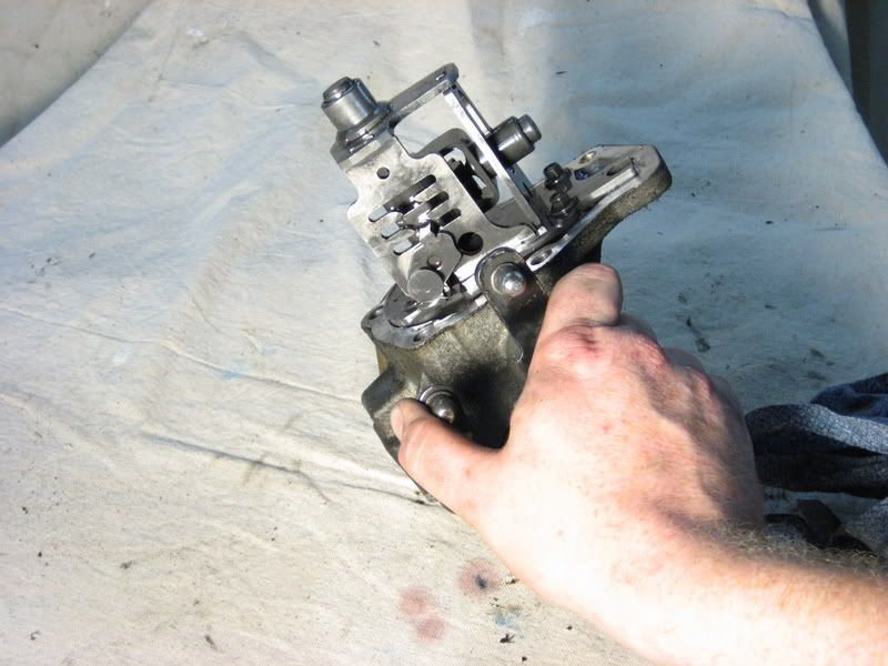

Here is what I removed

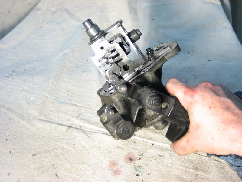

Nice close up of it out of the car.
When I move the arm on the left to the left the big dowel pin goes up
When I move the arm on the left to the right the big dowel pin goes down
Now here is where it get interesting.

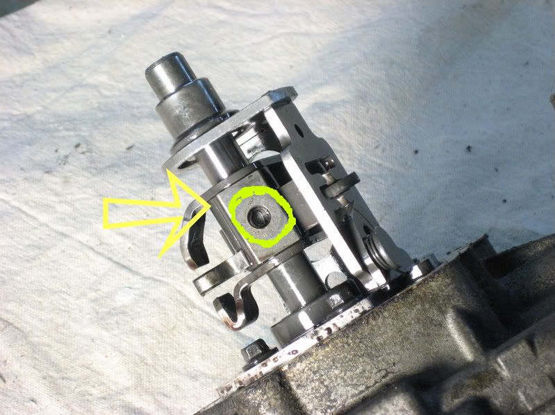

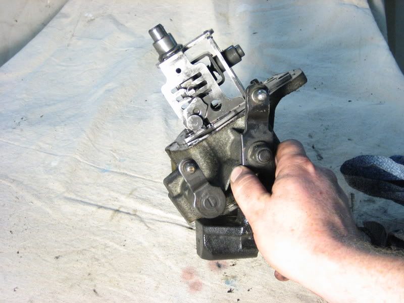

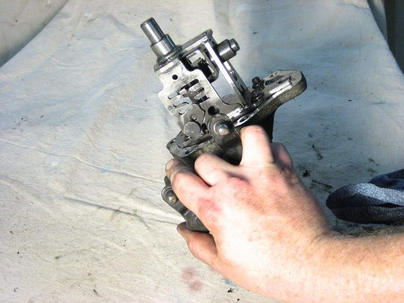

when I move the arm on the right the dowel moves but does not turn the h6 thing
It looks like a small pin is sheared off where the dowel connects
Is this thing shot? Can I replace the pin? A friend of mine suggests a new trans because this sheared pin implies metal chunks in my trans. And that would suck.

well I disassembled the whole thing last night. Kind of a brain teaser puzzle how it all fits together. Once I got the whole dowel pin out I realized the pin thats sheared off is actually threaded in. Thank god for my Grade 8 metric bolt kit I bought a while ago. Found one that threads in to the dowel and replaces the pin. I am still going to pull the trans and make sure there are no other problems. Ill also take some more pics and hopefully put this in the DIY thread.
