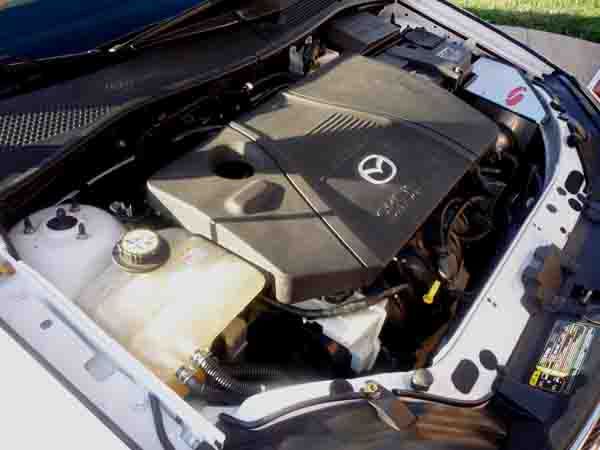

I knew I'd have to make a cut by the P/S tank, but it's a whole lot more than that. I won't know if will fit at all, till I start cutting the thing. For starters, the cover hits the coolant tank, and won't clear the fuel line. And I don't know if I can use the front mount peg. At that spot the fuel pressure sensor might not clear the cover part. The back two pegs might fit. But I'll have to do a bunch of mods before this cover is on there.
I think it'll look good though....the under-side has a fiberglass pad to stop some noise. Anyway stay tuned. Got the weekend to work on it.

I think it's off a Mazda3 (got it used).....which is basically the same engine as the Duratec. That's why it's a close, but not perfect fit. When installed this should give the Duratec a finished look......rather than the mass of wires and hoses you see when stock.

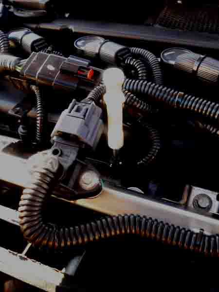

The three mount pegs are also from Mazda. They look to be nylon or some hard plastic with metal threaded inserts on the bottom. They just screw on the 6mm studs that hold the Duratec valve cover on. On the underside of the cover are plastic sections with rubber inserts. The cover should just push down and snap into the mount posts.....if I get it to fit that way.
There would be other ways to mount the cover, but I'm hoping it mounts using the pegs. Fingers crossed......

Boosta's setup is nice....gives an entirely new look to the engine bay. I haven't even thought about painting the thing yet. That will be the last step. And yeah the badge is a separate piece. I cannot see the back attachment though, because of the semi-permanently attached fiberglass heat pad, which I want to use.
After I get working on this later today, I may have a few questions. His was the only one of these covers I've ever seen installed. I liked the look of it so much I started looking for one like it.

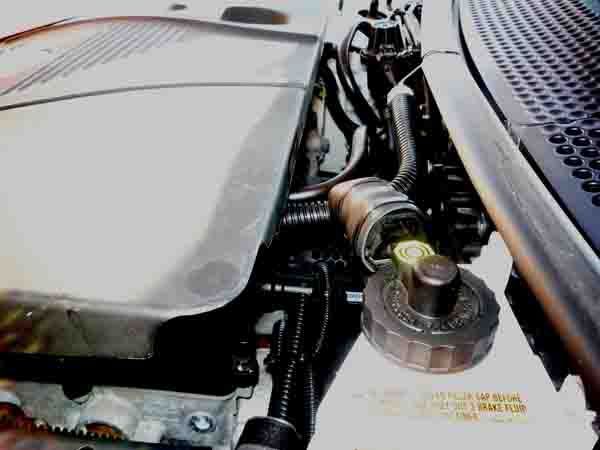

It lives.....mounted using the Mazda mounting posts, and nothing else. Maintenance will be easy, because the whole thing just pops off. The tops of the posts are rounded, and there's rubber inserts under the cover, so when popped in, the cover is rubber mounted.
I had to make one long cut by the P/S tank. This clears the PS and the coolant tank, allowing some clearance for engine movement. And there were a few more cuts here and there. At the rear, I had to loosen the fuel line mount bracket...and will re-locate it about 1" toward the driver side (allows free movement of the fuel line).
There are a few minor details to work out, but as you can see, it mounts nice. I didn't cut out the area over the P/S tank cap. It comes right out without removing the cover.
If anybody is interested in the details of the cuts not shown in the photos, I can take more photos. Now I'm wondering about the color...but the black will look ok once it's all cleaned up.
