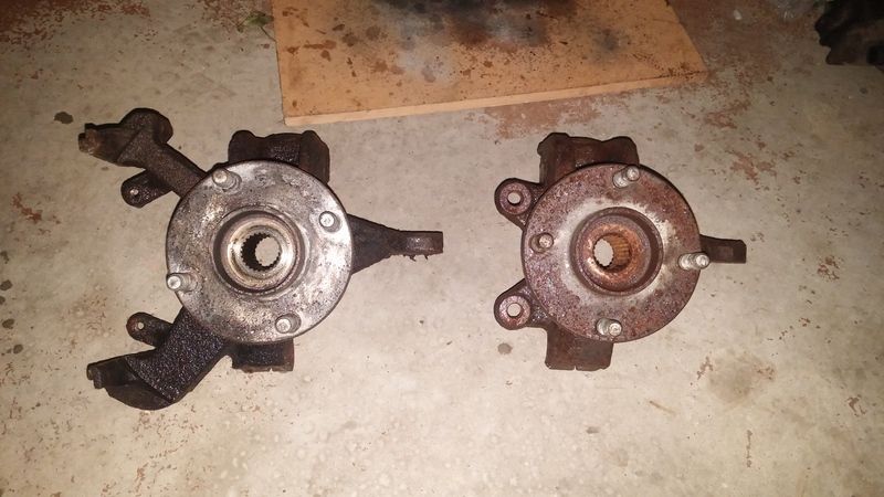

If you don't already have SVT or '05 - '11 knuckles, you'll need to find a pair and put them on. I have a plain old MK1, so I had to do this. In the below image, the SVT knuckle is on the right. Note that this is a great opportunity to get new wheel bearings pressed in.
It's also a great opportunity to inspect the tie rod ends, ball joints, sway bar end links, and CV joints for tears in the boots or overly tough movement. I replaced tie rod ends on both sides because they were torn, and one sway bar end link for the same reason.
Try not to damage the ball joint and tie rod end boots when separating them from the knuckle. Especially if you're using pickle forks. I ended up buying a specialty ball joint separator to do the job.

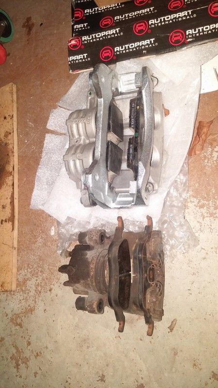

After the new knuckle is on, it's time to start installing the kit. This is the part where I'm lacking photos. I do have new / old comparison shots though. New aluminum, two-piston caliper compared to stock:

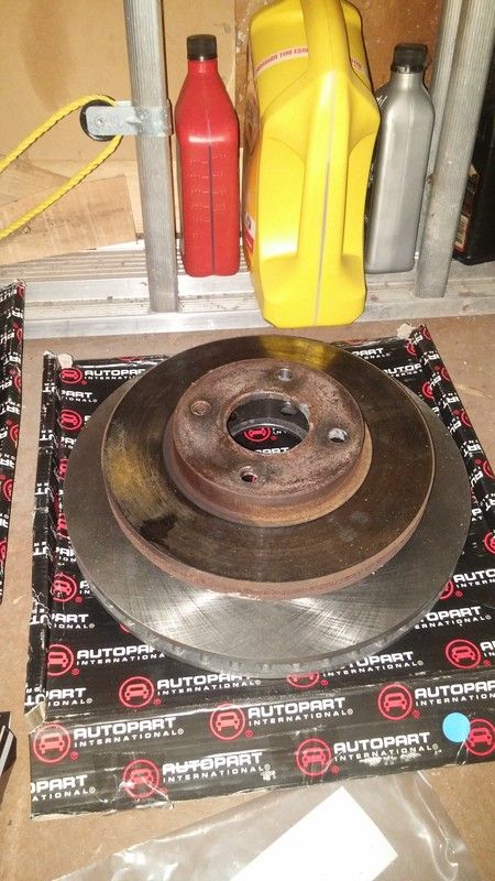

New 13" rotor (bottom) compared to stock (on top):
Fast forward a bit and you'll be looking at this. The purple thing is the Massive bracket that bolts to the knuckle using two bolts. Then the caliper bolts onto that bracket. Braided stainless steel flex lines are also included, with a small bracket to locate them onto the main purple bracket.

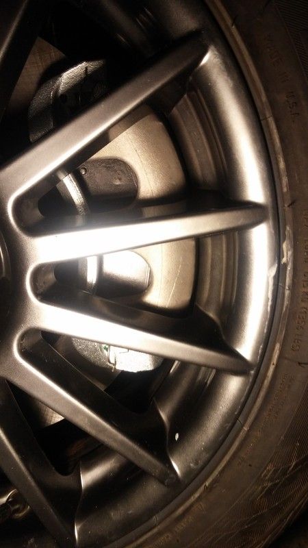

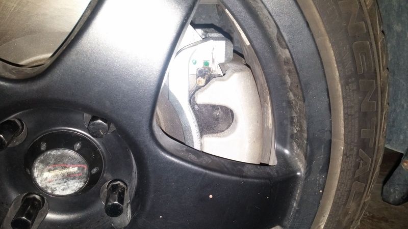

Wheel clearance
You need at least 17" wheels to clear these brakes. EAP wheels will just barely fit, but I wouldn't do it. The caliper is quite literally a millimeter or two away from the wheel barrel.
I have 17x7 Team Dynamics Pro Race 3, +42 offset, and they have more comfortable clearance.

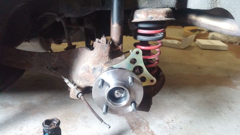

First, remove everything relating to brakes in the rear, until you're left with a bare trailing arm. Unfortunately, I don't have a photo for this stage.
The four bolts on the backside of the trailing arm that secure the spindle will be corroded, tight, and be incredibly difficult to access. You need to unbolt the lower shock mount and get creative with how you position yourself and the ratchet.
This is a good opportunity to replace other rear suspension components if you need to. I replaced both lower control arms since they were really rusty (photos later).
Sandwiching Massive's bracket between the arm and the existing spindle. The caliper bolts to this bracket.
And then the new hub with fresh wheel bearings goes onto the spindle.

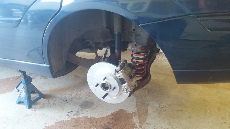

Here are some photos of the end result:
Brackets are supplied to locate and route the parking brake cables and flex lines at the camber arm. They are nicely done and keep things away from the wheel and shock.
New control arms too:
Then bleed your brakes and get an alignment. The finished product:

  • My only concern is with the front rotors. They are not stock Mustang GT rotors; Massive has machined them to be slightly smaller diameter and so they are the only source for replacements. I don't know what the cost is, and I don't know how long they'll be available for. I'll have to figure out a sustainable method long-term.

I wonder why they were machined down to a smaller diameter that just makes it a pita really. I have an Svt and love the feel already but I like overkill better safe than sorry. What is the difference of the fronts in that kit compared to a stock svts fronts?
Hey, thanks for the comment. I don't know why exactly they were machined. At some point I will compare them with stock Mustang GT rotors to see just how different they are. You are right that it's a pain, because you can't buy off-the-shelf replacements.
As for the what's different between the front kit and the stock SVT:
Bigger rotor; 13" versus 11.8". A more powerful caliper; 2-piston versus single piston. And braided stainless steel flex lines. All of which translates into less brake fade and more stopping power.

If you were to run your EAP wheels, what sort of problems are you worried about? I ask because this setup is something I am interested in pursuing.

I simply feel uneasy with how close the barrels of the EAP wheels are to the front calipers. I sold the wheels because of this. I am not exaggerating when I say that there are only a few millimeters of clearance. If any little thing goes wrong (i.e. lug nuts not torqued properly, slightly bent wheel), the caliper is going to drag on the wheel and you are going to have a bad day. My other wheels are also 17x7 +42, but they have more clearance somehow (Team Dynamics Pro Race 3).
